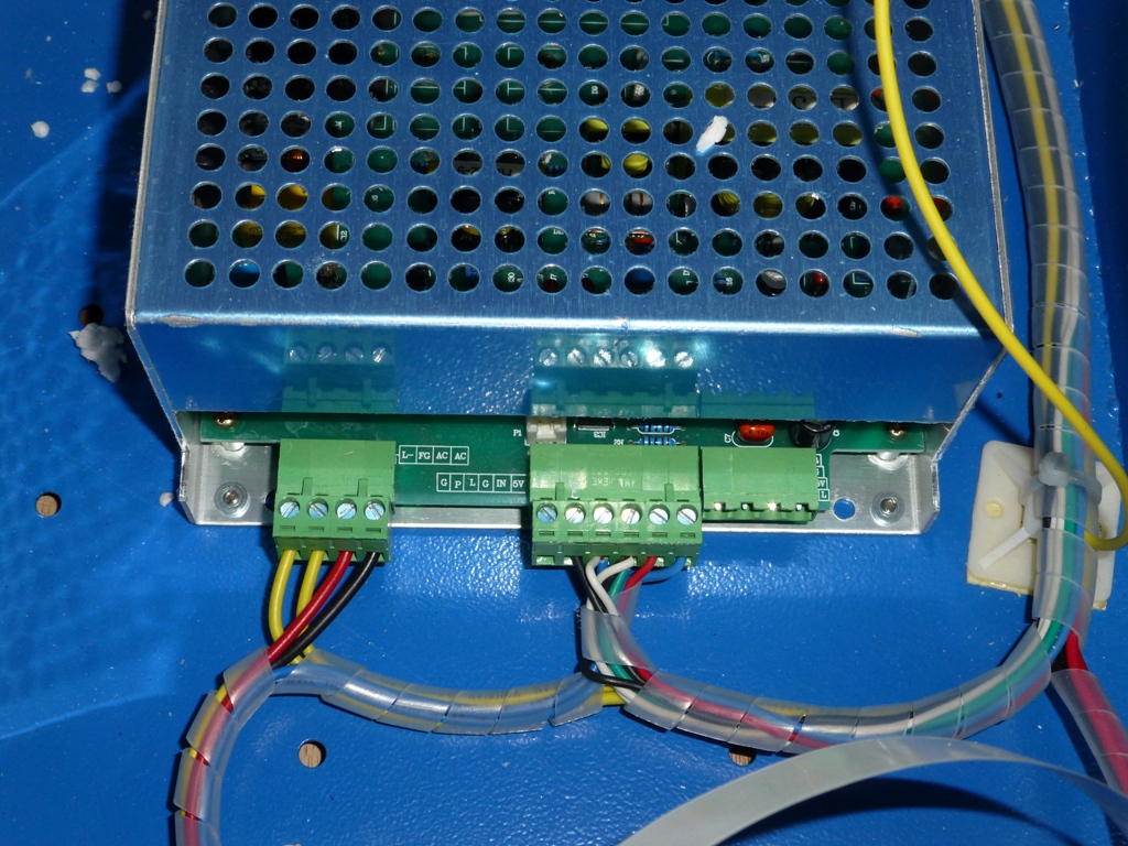

do i need to replace the power supply of my laser?
Picture of my power supply is attached.
Thanks Amnon :shock:
Re: The power supplay question
It may work but not without trying 'hard' to figuring out the connection. Plus, the result of engraving would not be good as a PWM power supply. You may lost 'gray scale' look. So, I don't recommend this power supply. It's good for 'single level' output only. Ideal for K40 cutting.

Is the PWM PS in the K40 upgrade kit ?
If not what is your recommendation ?

No, PS is not included in the kit. You need to buy it separated.
