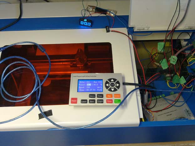

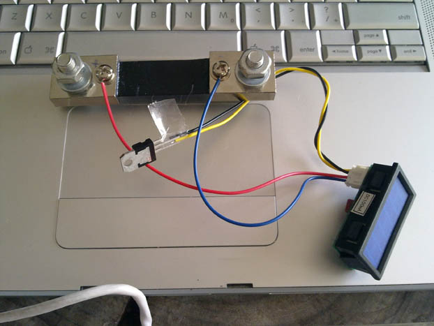

Based on the the mock setup and pwr source tech photos for the 100mA meter the reference states the meter requires a shunt... I set up my meter with the iso and an interpretation of the wiring based on the photos... likely incorrect since the LED does not light at power on... that said I've yet to identify a suitable power source for my meter since it is a 24V05v ... what do I connect to on the 24V V+ and COM?? my K40 laser PSU has a discrete 5V - have some folks used this as a direct power for the meter? And what about the shunt?- my understanding is the shunt is connected to the cathode (blue in most K40 cases) and the PSU neg (also a blue) across the shunt with the +/- inputs connected from the minor inside connectors. I am unable to power the meter at all in this configuration= where does the meter get its power? 12V 24v or 5V or otherwise. Does one ground it to the PSU or the 24V or the chassis as in the original analog configuration? I connected the cathode wire to the meter's positive = no power; cathode to the shunt is the same result... thus i suspect a separate outside 5V power source is required. As someone who isn't electronic I don't see the missing link described as load in the photo ya sure that's the Voltage source to be measured but how is it that the meter is also powered? The shunt seems a hedge against feedback... comments welcome solutions encouraged.. thnx
dscvrd in forum that simple drop w/out isolation does not work... see pic works w 2405cs OK
