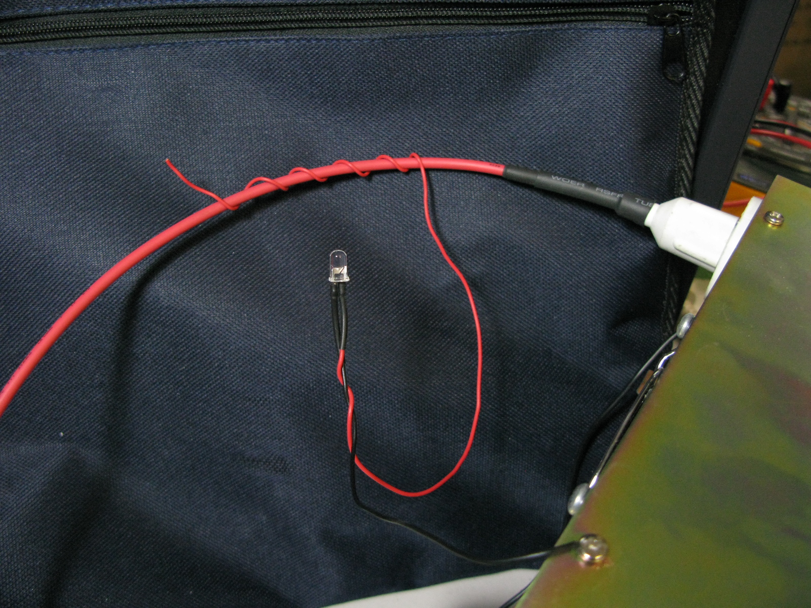

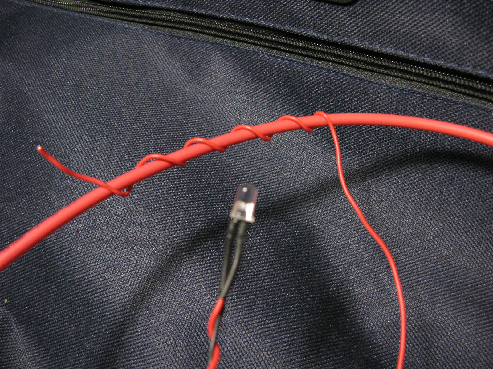

Make a cheap cheap setup to test if the Laser Power output anything. Note, it must be in 'closed-loop' setup which means that a laser tube must be connected. Don't test the laser power supply without a load - laser tube connected!
Once you press a "Test" button (if any), or you fire the laser, the LED should light up. The LED I used is a regular 1.5V and I coiled up the wire about 5 rounds with LED poitive leg to the HV cable and the negative leg connecting to the case (ground). Note that the LED light up brigher if coils are stretch out than tighten up.

Though the simulated test was not successful, we were able to determine that the laser tube is still functioning by depressing the red test button on the laser power supply box. When the red test button is depressed, the laser fires and the power gage show a strong amp - so the tube is still working. The software running the laser is working as an uploaded file is calculated and the laser arm will "run" the pattern, but the laser will not fire.
