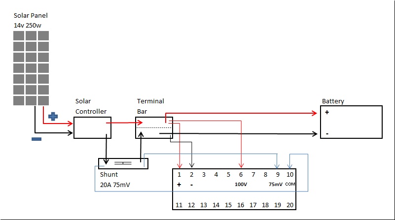

Hi,
I'm using a JLD404 with a set of solar panels. I'd like to measure both voltage and current. This is the setup below.
(If it isn't clear, the panels are 14v 250w total. I also purchased the 20A 75mv shunt.)
Question is: is the setup as simple as I've drawn? All I really want to measure is Voltage, Current and accumulated Ah over a period of time.
Have I got it right?
Thanks!
adam_adz

I called the company and they did a great job confirming that my drawing will work. The only thing to change slightly, is that Ground to the number #2 pin will come from a grounding source that is directly to the battery, and not through the shunt as drawn.
I’ll report back and confirm once I’ve got it installed.

There is a little missing on your diagram. You forgot to take input from the battery which is by default #6. Without it, you can't read voltage on the battery. The diagram you're showing will just power up the meter without voltage but the current only
I did post a manual on the Manual section. Download it and go through it before doing installation.

I'd already posted the picture before I talked to you.
Here's the new diagram. I hope to get to the project soon. I'll report back when it's complete.

You should put terminal #6 to the battery instead of the terminal bar.
Here is the setting that i think is to properly set up the AH meter.
A-Sn->75mV since you measure more than 5A
APvH->20A you may need to adjust decimal point to get 20A
V-Sn->100V
UpoH->100V
Please let us know if it works.

APvH 99.00 should set to 20 because you are using the 20A 75mV shunt
The negative sign of current reading may caused by the current flowing backward because the voltage generated from the panel is less than the voltage of the battery at sunset.
