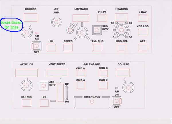

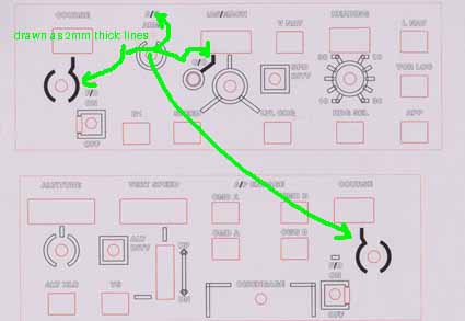

If I draw a line in Coreldraw and make that line 2mm thick. When it exports to Lasercad the 2mm lines show only as hairlines and do not engrave at all.
In an attempt to work around this I draw the same line but as a 2mm thick rectangle...this almost works, except, when its sent to the laser via Lasercad it some times "drops" or loses part of the drawing.
In an attempt to save the workpiece I try to redraw the missing bit, delete the stuff that did engraved, then try to send just the redrawn bit.
I get an "data empty" message (although I can see the lines etc clearly on the screen).? (I cant find a way to "thicken" the line in Lasercad)
If I send the whole drawing again (with my new redrawn bits) it engraves happily and again misses bits(the data empty bit I assume)

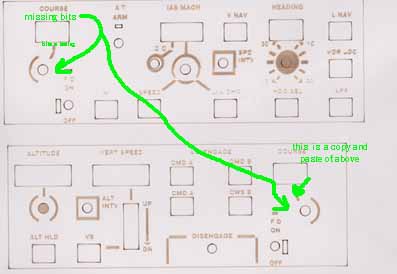

It carried on to the second (copied and paste) "missing bit" and the head juddered severely (making the horrible noise that you used to get when moshidraw crashed the head into the far corner) and the rest of the engraving and the subsequent cutting was displaced.
I have tried completely redrawing the item and this time a different section "went missing"
It has done the judder and displacement to other projects too. once it went 40mm out of alignment.

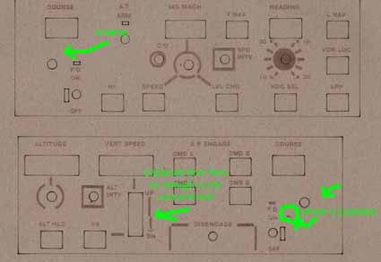

opps last one ya cant read
It shows missing bits (or rather doesn't lol)
where it 'Juddered' (bottom right)
and displacement

I think the missing bits problem was lines in the drawing meeting but not "joined" does that make sense?. (My sister uses Autocad for her work and drew my attention to this)I will send the file in case there's something spurious in it that causes the judder. A different vesion of this drawing engraved and cut fine with moshi except the board fried before I could finalise the drawing and to the final job.
The juddering,when it happens, (seems to be at random) causes the rest of the engraving to be displaced (to the right)
anything from 10mm to 50mm I assume this is "skipping"?
