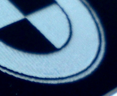

I'm engraving IPI brand laser plastic right now and I'm getting lines across the engraving. Looks kind of like the laser going in too deep and leaving a groove. Well, this made sense when it was going across the X axis. I just ran another piece and all of the sudden the line is running the other direction even though it was still engraved across X. I have attached a photo.
Since it's going vertically now I assume this is a software setting. Is there anything I can do to make the engraved area look smoother? Not a big issue in something like wood but on engraving plastic or metal it's very noticeable.

- engravinglines.jpg (95.79 KiB) Viewed 3803 times

take your dpi down to max 300dpi and the power too.
did you reasamble the JPEG down to the size you wana engrave and then save with max 300 dpi.
then set the scan gap to 0.04.
the higher the resolution you set on the laser the more sometimes not visible stuff is pickt up.

I'm doing a batch of small name badges on plastic and I just can't make them look good unless I save the images at 400 dpi. And from Coreldraw I also select 1:1 so the images are the exact size when I import them (no resizing). Anything lower has jagged edges.
I also tried lowering the power and speed which actually produced very nice results except for the vertical banding in the photo above. Other than that, the text and logo look perfect.
I'll change the scan gap and see what results I get. Should I be messing around with the PPI setting?

you should not use the ppi at all for this things.
just send me the file to a542002@hotmail.com and I will see whats going on

I appreciate the offer but I'm not sure you could reproduce the problem even with the file. On this IPI laser plastic it's doing it no matter what graphics I try.
I did get it looking a lot better by reducing the power, slowing down, and lowering the scan gap a bit. I did a LOT of testing and there seems to be just one sweet spot for this material and that's not perfect either.
I honestly don't think it's going to get much better. It still has a very fine pebble appearance where it's engraved which is a bit disappointing since I'm used to using larger machines from Universal and LaserPro that make a very smooth mark on this plastic.
It's almost like the power isn't 100% consistent. I suspect on most materials it wouldn't be a big issue but you can really see it on this stuff.
I don't know, maybe it's a bad batch of plastic for all I know. I'll see if I can get some Rowmark plastic tomorrow and see if the results are different.
If there are any other settings I should be looking at let me know.
