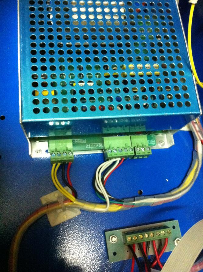

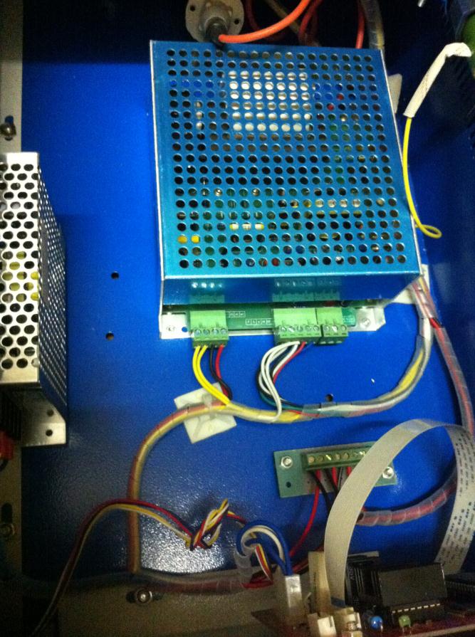

you can use all of the mechanical and optic parts. with your powersupply I am not sure because it looks like the laser power supply could be a analog what is not for the new DSP, and you have to check your 24V main power supply if it can bring 23V and at least 10A.

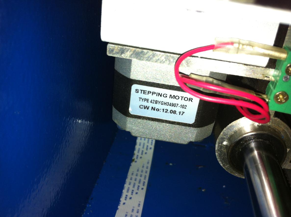

I personally would use the 2M504 not the TB6560 I had some probleme but this depends on what stepper motor you have in there you need to read the label on the motors.

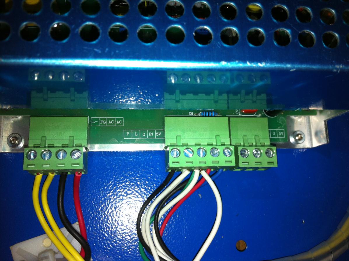

Thanks for your reply. I have retaken the photos of the laser power supply and other parts like main power supply and stepping motor labels.
I don't know the laser power supply is a non-Pulse Width Modulation (PWM) power supply or not but it looks like a new model and I can see alot cables connected to it.
My machine's stepping motor label is 42BYGH34907-102. Do you know what Motor Driver I should use? the 2M504 or the TB6560?

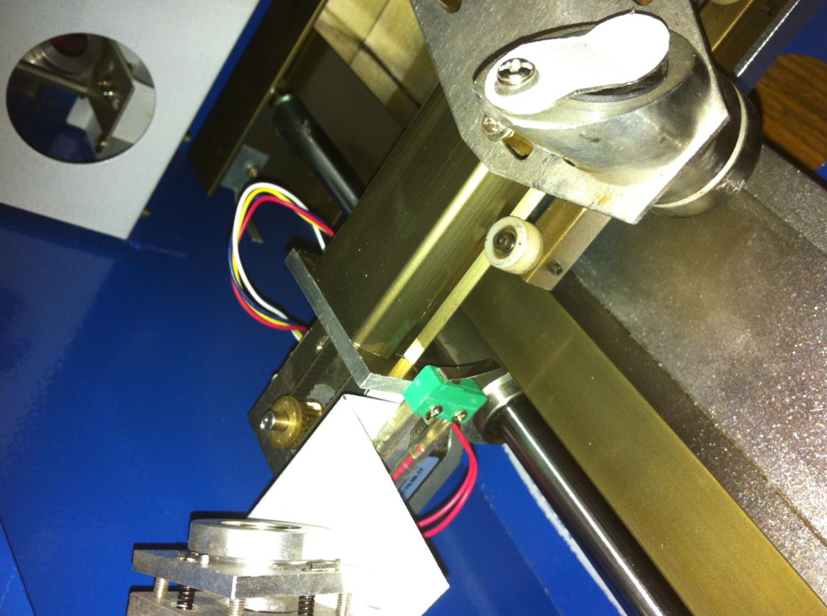

I can see there is one limit switch on the machine. I don't know it's X limit switch or Y limit switch. Do I need to buy 2 new proximity limit switches to replace this original one?
By the way, I can only see 4 small wires connected the X motor to the board. It's supposed there's another 4 small wires for the Y motor but I can't see it. Do you know where I can find it?
