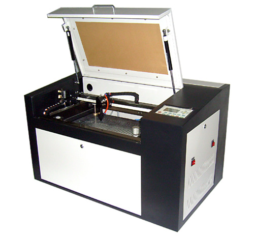

I have a Shenhui 50watt CO2 Laser with a 500x300 cutting area purchased on Ebay. It is the same system in the auction linked below:
http://www.ebay.com/itm/CO2-LASER-ENGRA ... 3a6e3cc857
After a year of reliable function the LCD panel seems to have shorted out. Since I need to replace that part I might as well upgrade. Since most of the discussion seems to be about 40watt, and K40 systems in particular I am curious would the DSP controller being sold on this site work with my laser?

A new DSP controller should work fine with your unit. Just follow the wiring diagram in the manual and you should be good to go.

I have bought a couple of machine from Shenhui but will never do it again. See the images I attached. I will retrofit it with the latest DSP once I got spare time.
Shenhui machine is cheap but quality is an issue. It took us a great effort to make it run better and fix some stupid things like 'fake' ground. Double check the AC connector, the ground always left unconnected!!
