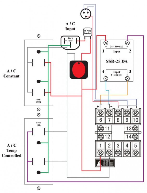

I've just wired up my JLD612 to an SSR and am now attempting to set it up through its menu system. I've selected J for IntY as I have a j-type thermocouple. How do I get 0.1degF accuracy rather than the 1.0 degF accuracy it is currently set to? I have set the CorF to 1 for fahrenheit. Also, I don't understand what outY option I need (I am currently using the default setting of 2). I've attached the wiring diagram that I've used if that helps answer my questions. The diagram is a little misleading as it shows a 3-wire thermoresistor in the setup but I am actually using a 2 wire J-type thermocouple.

The 0.1 deg option is only available with Pt100 RTDs.
As you have probably discovered, you can offset the temp reading to be essentially correct.
