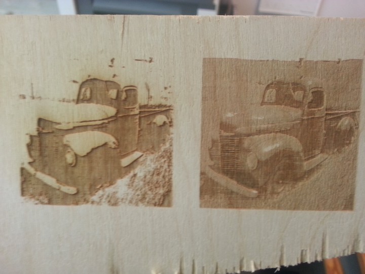

Ok, here's a pic. Both are the exact same image at the exact same settings, only difference is left image is normal engrave, right image is dithered. When I import from corel I can do normal engravings just fine, it's only dithering that I cannot do. The image on the left was dithered in corel then sent to lasercad via macro, but as soon as it gets to lasercad it's converted to a 1bit B&W image and is no longer dithered, and the dither option in lasercad is grayed out (as with any image sent from corel).

ok if you dither a picture with any other programm you can not dither it again in lasercut, but even if it apears to be just black and white the dithering information still is there and the laser will do iot as dithered..
all depends how you prepare the picture and what dithering option you use.
if you import a picture directly in to lasercut you will have the dither option then you need to chose a dithering seting
this can be tricky and you probably need to do some tests till you are familiar with it.
the best and easiest way to prepare a picture is :
take it in corelphoto paint - then resample it to the size you wana engrave you need to do this before any more is doen to the picture
then you need to convert it to 8 bit grey
then you need to do contrast enhacment and gama adjustment to 1.30
then you go to effects and unsharp it usually slide the slider over all the way yo 500 and radius 3
then safe as JPEG
then import it to lasercut and dithere it if very detailed then dither it with 0.01 if it is normal detail use 0.1 .
depending how it comes out you have to play with for max result.
