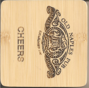

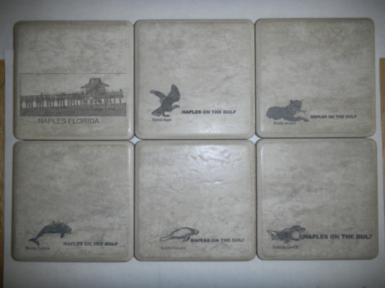

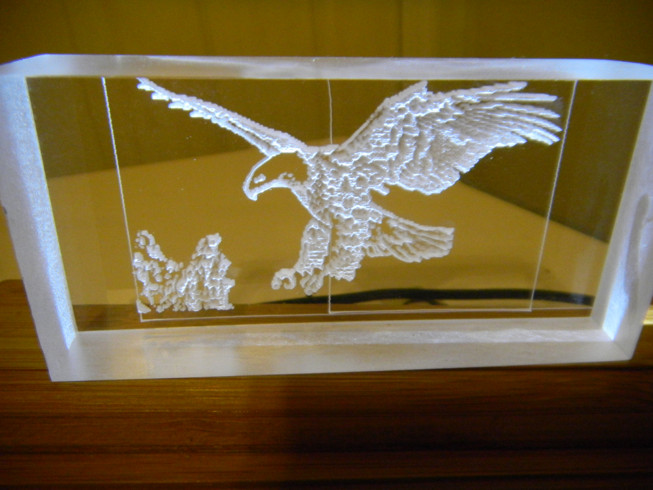

I use that machine my company. i make corporate gifts several company their own logoToasty wrote:I'm getting ready to purchase a k40 laser and dsp kit for a conversion.
I'm curious if anyone is using this setup for any light production work?
I plan on using mine mostly for engraving things like name tags and small acrylic awards. I may be using it for several hours a day at times.
I currently work full time in the awards industry using Laserpro and Universal lasers so I'm not really new to all of this but I also realize that this is a hobby grade machine. I'm aware of it's limitations but a small desktop machine is really appealing for what I'm planning on using it for.
So, is anyone on here using their machine for something like this? If so could you maybe post up some examples of your work?
Here i's one example sauna meter
http://www.youtube.com/watch?v=rUKTEUBL5Oo
i allready make those meter about 1500pc and still working
www.pairtec.com

Thanks for the photos! It's good to see that you can use one of these small machine for serious work.

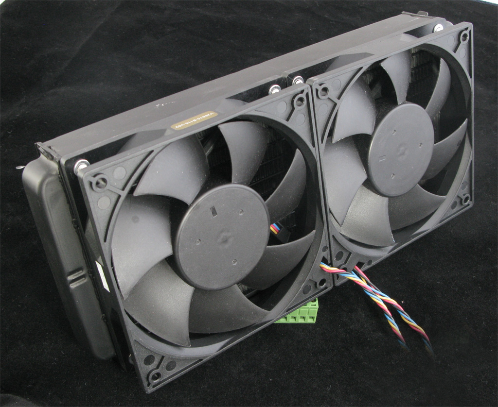

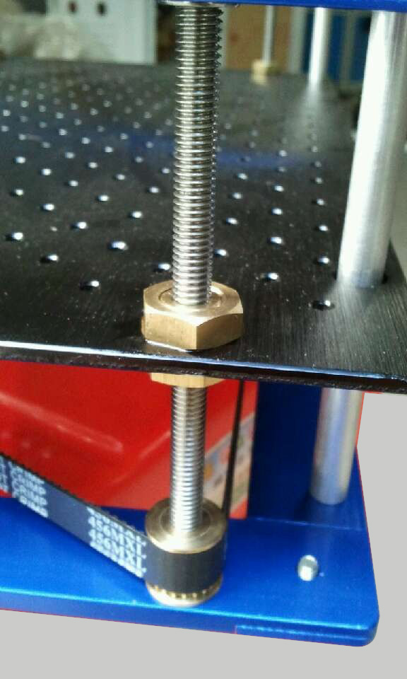

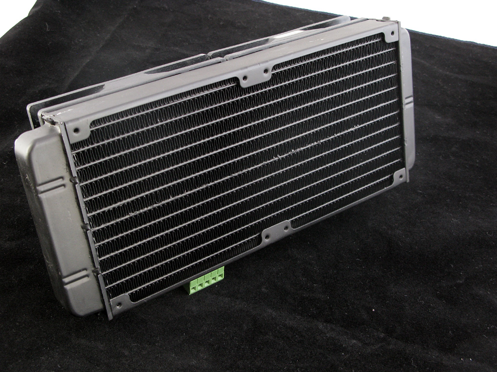

Ok... For all of you running your machines several hours a day, what kind of cooling are you using for the tube? Just water or are you using a chiller?

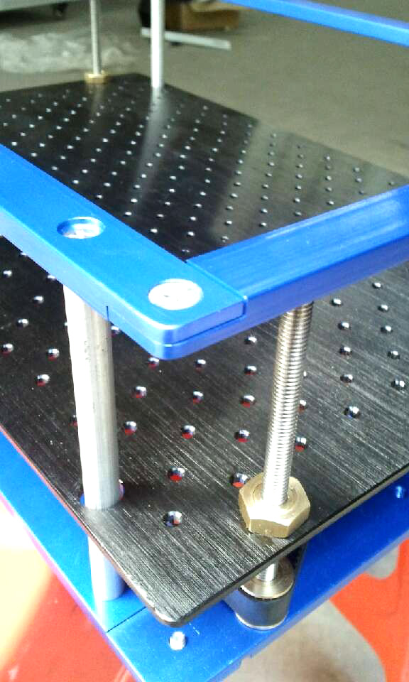

Also, has anyone made a manually adjustable up/down table for their machine? I'll probably buy the one from here when they have them back in stock but I would love to see what everyone else is doing for a table.
I'm also curious to see if anyone has bolted rulers down to the top and left on their table so they have a repeatable starting point for multiple items. All of the USA machines I've ever used have this but I've never seen it on the lasers from China. That's something I'll have to modify right away.

Re: k40 with Lightobject DSP for production work?
For the K40, an air-cooled system 2400mm water cooler + dual fan and 2 gallon of water should be good enough. See pictures. No chiller is need as it is a 40W laser. Don't waste money on that unless you have 60W or above, then you will consider a chiller. I'm assuming you're running the machine indoor with 72'F or below.

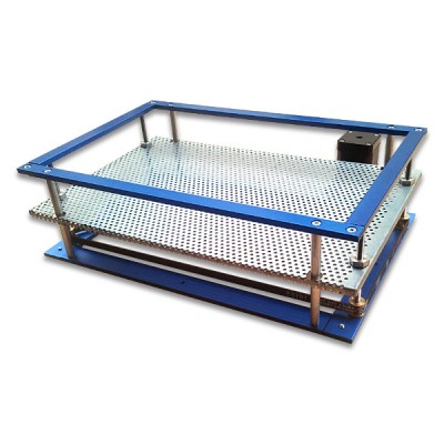

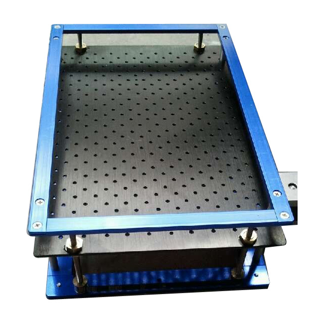

The production of the power 'Z' table is almost done. It take a couple more days to finish it. Then, it take about 7 days to ship to me. You may want to pre-order now as I may have 20x coming for the 1st patch. Then, then the next patch may take at least a month or longer to get it as Chinese New Year is coming. The whole nation celebrate the new year for about a month.
Actually, the new Z table is improved with better threaded rod and panel. Note, the holes array showing in the picture is less than the actual table. I asked the tooling company to double the density as it's better for cutting, especially for the acrylic. The panel is thicker than the prevous version so it won't bent when heavier object loaded.

Hi toasty,
I can tell you because I did it to build your own up and down table does not come cheaper then marcos table as I did it it was not available at the time.
with the water cooler the version what marco has recomended is very good but you need a digital termmometer the best is one with a switch and adjastable because the laser tube should be driven between 66 and 72 F. below this the tube does not have the working temperature and first heat the tube to this what makes a bad engraving or cutting, above them is dangerous for the tube to be destroyed due to overheating.
I had 5 case during the last 6 month where the guys did not watch it and did go by hand feeling the temperatur and destroyed the tubes.
another priority is the measurment of the curent if you dont wana spend the money for a digital mA meter then connect the existing analog mA meter back between the tube negativ and the laser tube power supply, watch that the cuurent does not exite 18mA here I had another few guys who believed that the DSP takes care ov the curent too thats not the case at all the max power setting should never go above 48% thats 18mA.
I hope this helps
