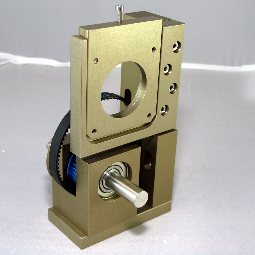

Yes. The metal wheel that used on the slider is running about $3 each with ball bearing. The metal pulley wheel for the stepping motor is $5 each. Technically speaking, I can get any parts in case it wore out. And if it's wear-out in 5 years, I will send part for replacement, from wheels to the motor.Guldberg wrote:What about spare part for the XLE 900. Is it possible to buy extra wheels? Seems like the only wearpart not standard.
FYI,I do carry 2:1 reduction gear (not designed for the XLE stages) for X and Y. I'll post it very soon. Plus, I will get the stepper will with 'blue dyed' color for 57 series (NEMA 23) motor in 8.0mm and 6.35mm. Wheel for 42 series (Nema 17) motor with 5mm hold diameter is available in about 2 weeks.
