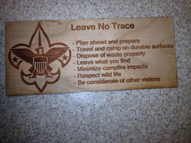

Just wanted to share a success story. Converted my K40 last weekend, tweaked, and now able to engrave/cut with great ease.
I now need a good fan to suck out the fumes. The one that shipped with the K40 is junk. Any ideas on fume evacuation?
Thanks!
David
