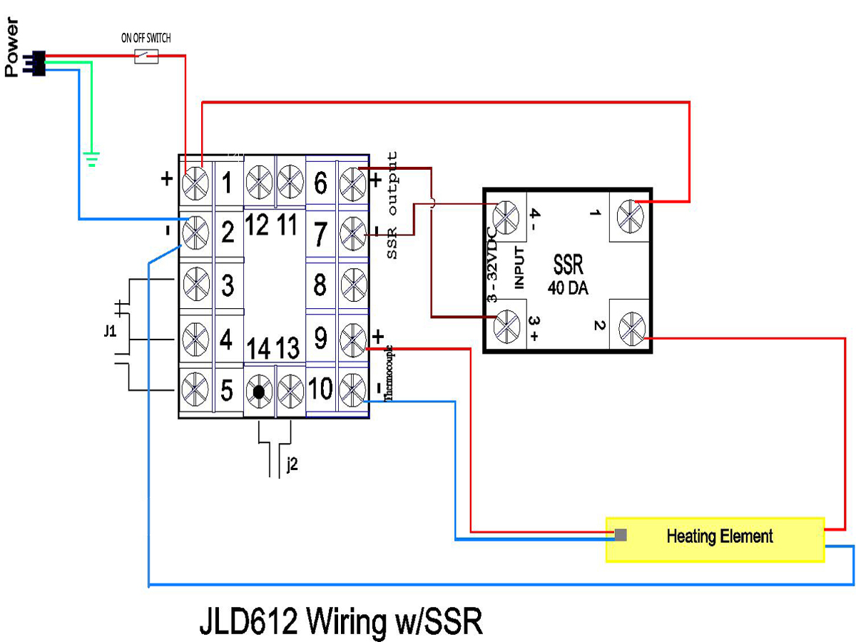

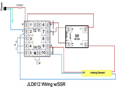

Thought this wiring diagram may be helpful to some..
