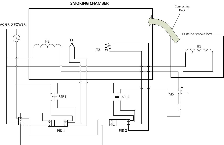

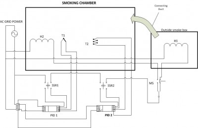

Re: JLD 615
Hi Richiem,
I think I got your reasoning. Generating smoke make make the temp in the smoke box to go way past 100F so I thinkl its better to generate it in an outside box and pipe the smoke in. My question is. Is there a more elegant way of doing it instead of using the manual swicth MS. It kinda takes away the auto control.
I appreciate the suggestions.
Thanks.
Thanks.
richiem
- Posts: 270
Re: JLD 615
Perhaps you generate all smoke and heat from the smoke box -- then use one probe-PID-SSR to monitor/control heat in smoke box and one probe-PID-SSR to monitor heat in sausage and shut system down.
I'm sure there are several other ways to do this, including using a third PID to control the smoke generator separately from the control of heat in the chamber and sausages -- no real limit on complexity, but cost will probably become an issue....
