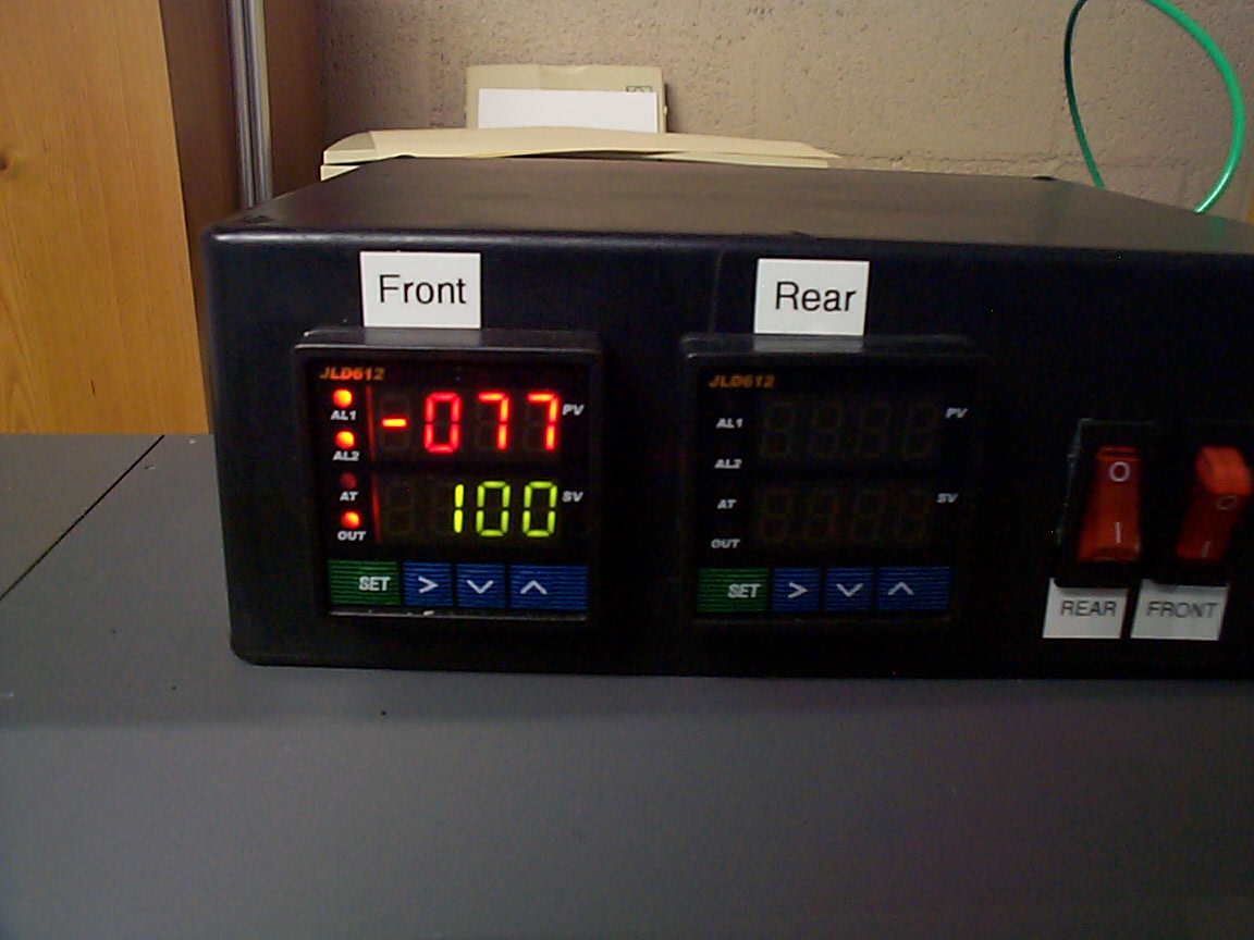

I am trying to get my JLD612 to hold a constant 100°F after entering Pv and Sv values the Pv values wonders all over the place while heating,,
I am sure I got something screwed up..here is a photo attached to see...any ideas Pleeeeeaaaaaseee...
JLD612 overshoots

My first rule for problem solving is: Check the settings, especially Inty and Outy.
After that, auto-tuning *may* provide the best result.

richiem, Thanks a bunch will work on it...I have a small strip heater I want to heat up to 100F..I almost had it working once...
Thanks again..
