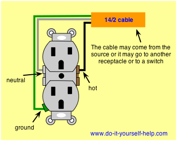

I posted a picture of basic AC outlet found from the Interent.

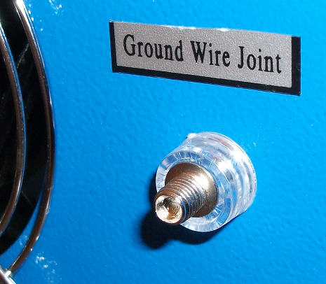

I'm a little bit confused what is the proper way to ground the chassis.
My K40 laser has Ground Wire Joint which is connected to E(arth) prong of AC plug. First I thought this Ground Wire Joint is connected to chassis but NOT. Both side has plastic insulation, the screw NOT connected with chassis. Earth wire goes from this Ground Wire Joint to laser supply, PS, etc, and they are screwed to chassis.
I think the best way is to connect E prong of AC plug to chassis directly as short as possible, so I don't know why Ground Wire Joint is insulated from chassis?

If that was a surprise to you then you expect a 'lot' of surprise from other engraving machine imported from China. I've been to this K40 manufacturer (pretty big factory) three times for visiting and ordering. I ordered 40x K40, four D340 and one 8060 from them. For each of machines I bought, I have to send my man to stay there to re-work before allowing the factory to let it shipped. Their quality control was bad and technically speaking, they have no "common sense". So, I gave up and never ordered machine from them. Remember that if you want to buy a laser machine, do not buy from the city "Jinan" , the ShanDong province!! Price is cheap but the quality is very low. Stay away from it even though you find a lot junk mail sent from those manufactures or you will be expecting 'trouble'
