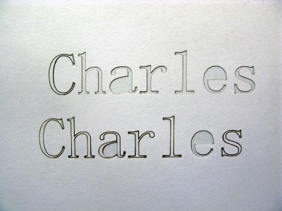

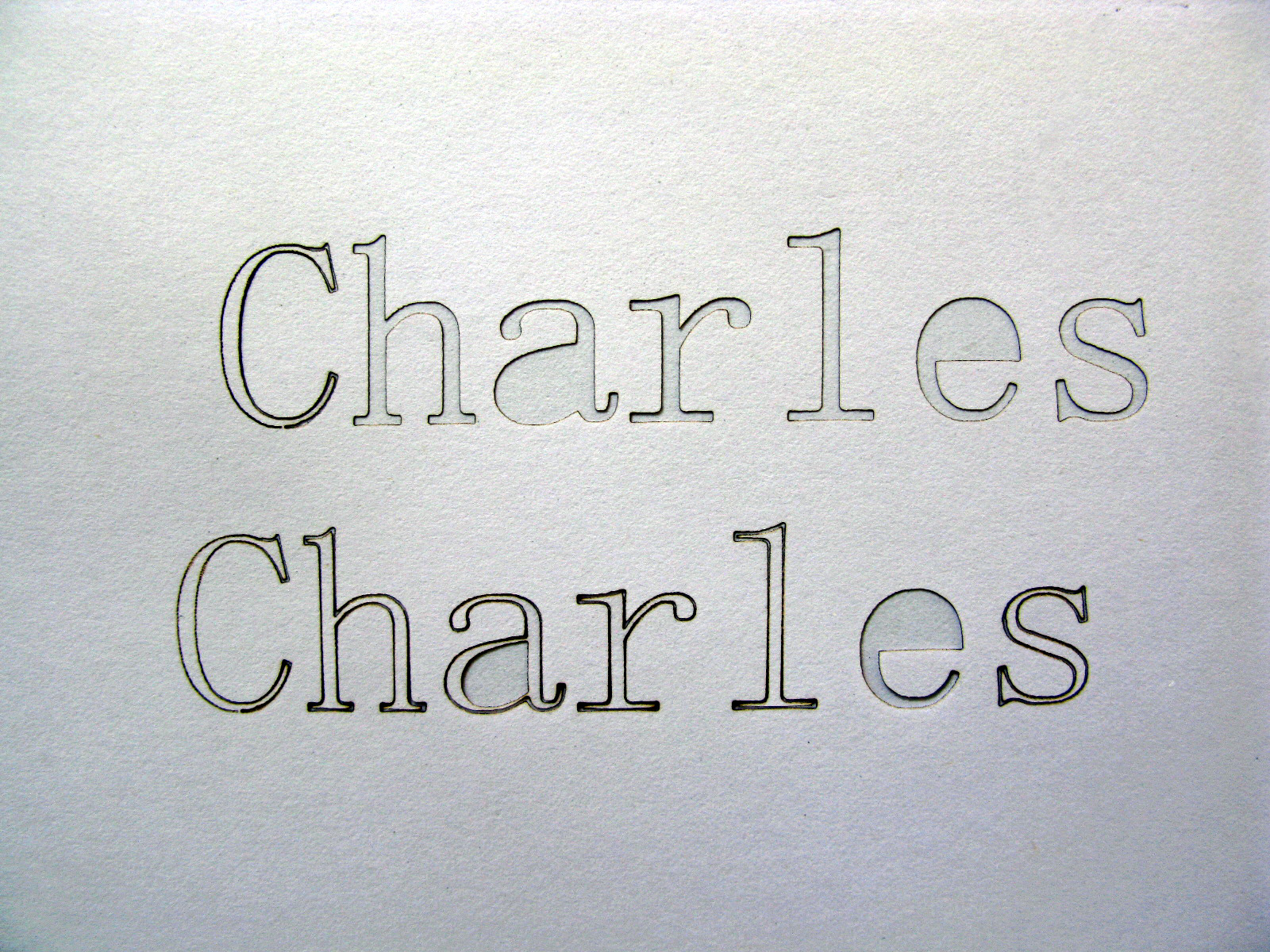

Some folks said that their machine couldn't find home properly or the returned Orign wasn't at the exact location it should after hitting Reset. I been testing it for at least 30 cards and I found nothing wrong with the Home/Origin. Check the videos I posted.
1) Cut 3 times with the same speed/power on each cut. Reset button was press on each cut.
2) Changed the Origin location and made 2 cuts. Same thing as above, hit Reset per cut.
See picture for the first Origin and the 2nd Orign. They're in exact location without any lose in step. Seeing to belive it.
