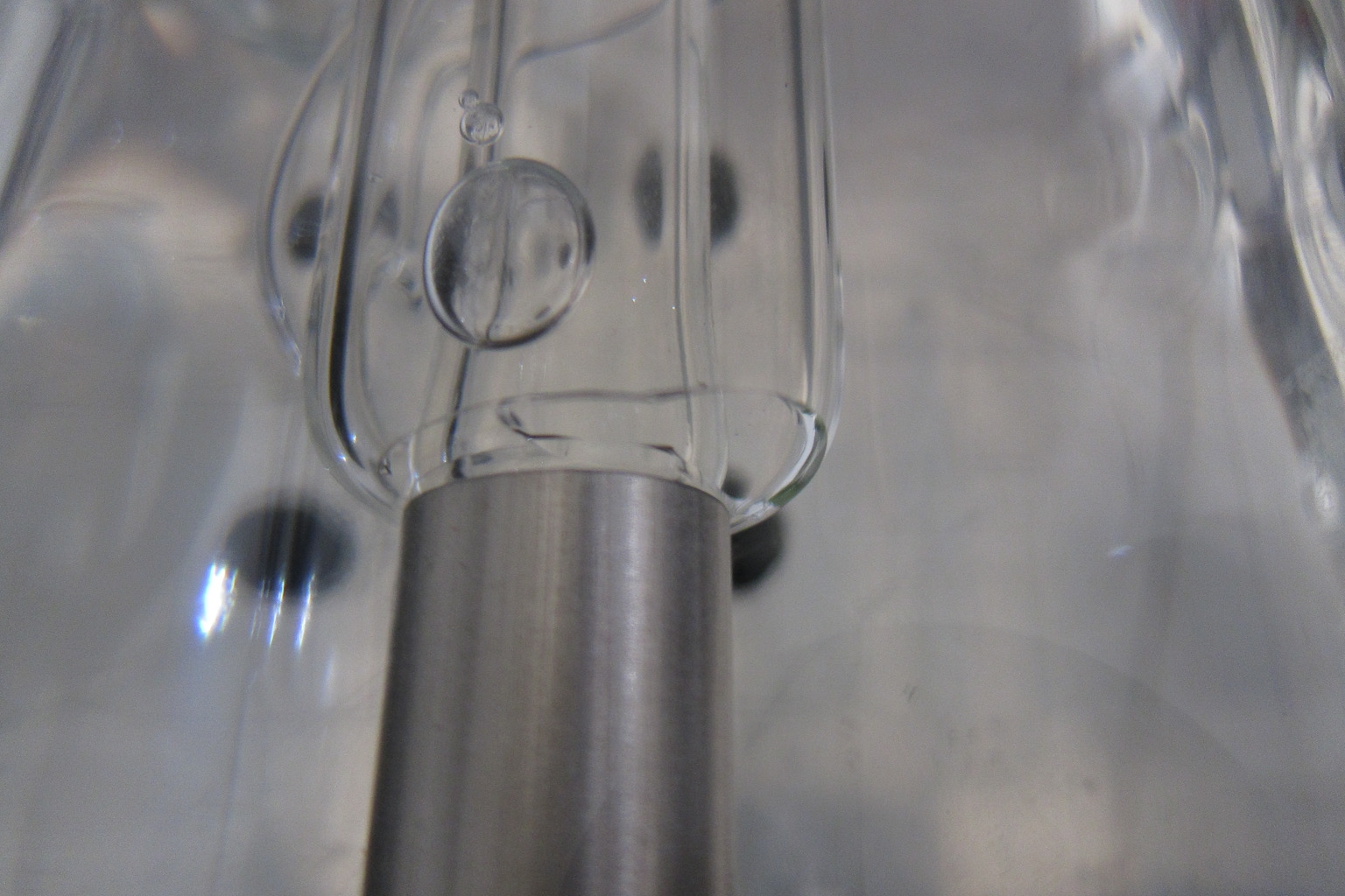

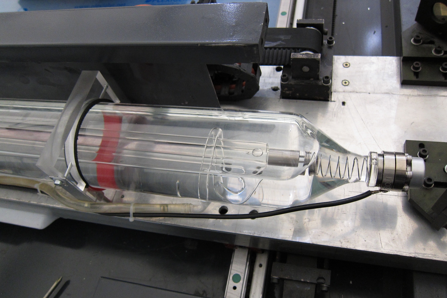

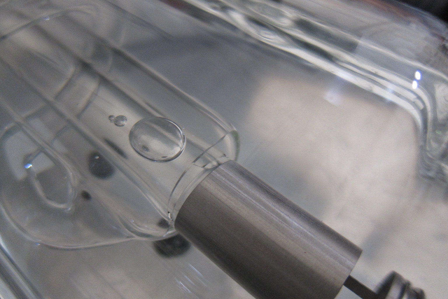

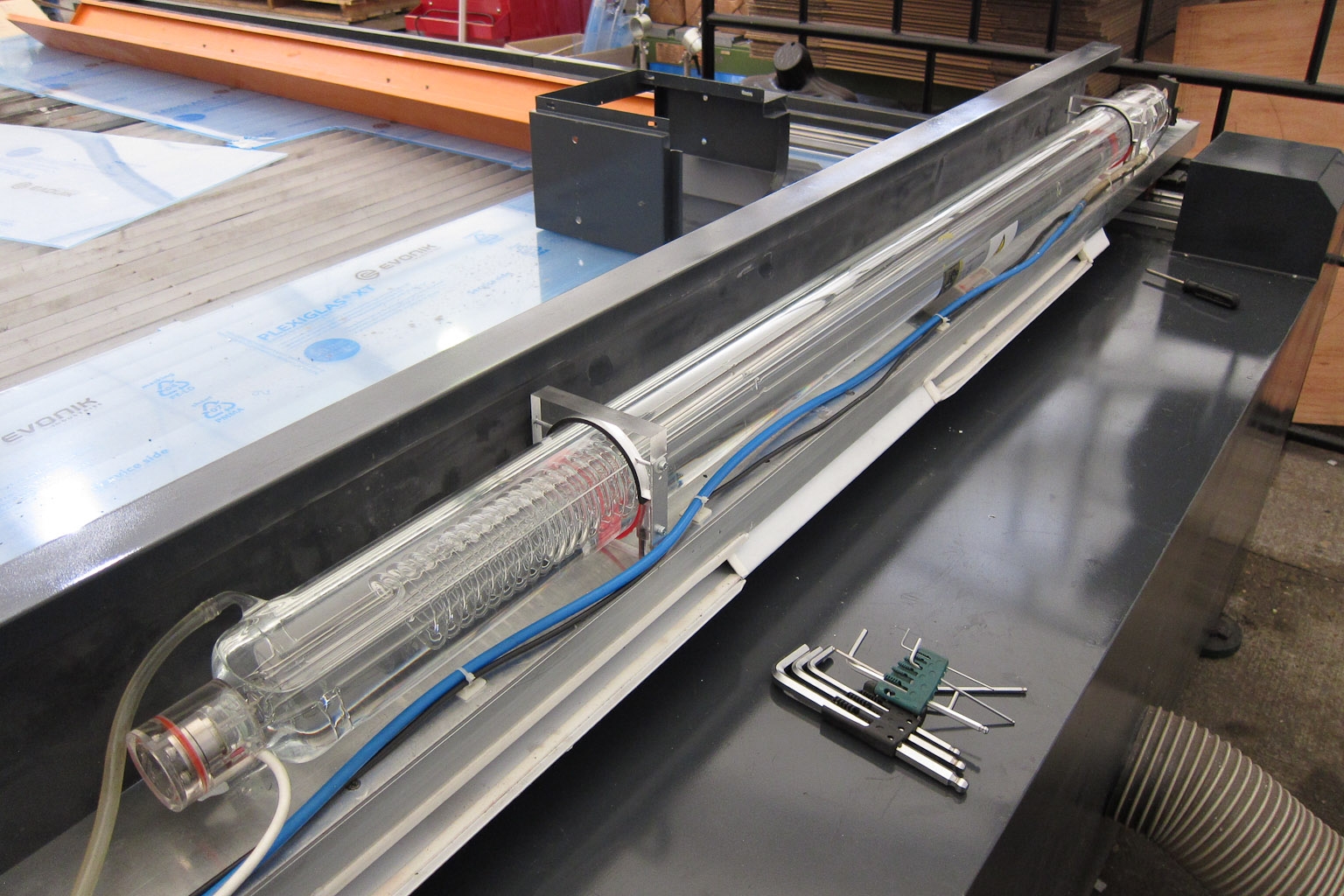

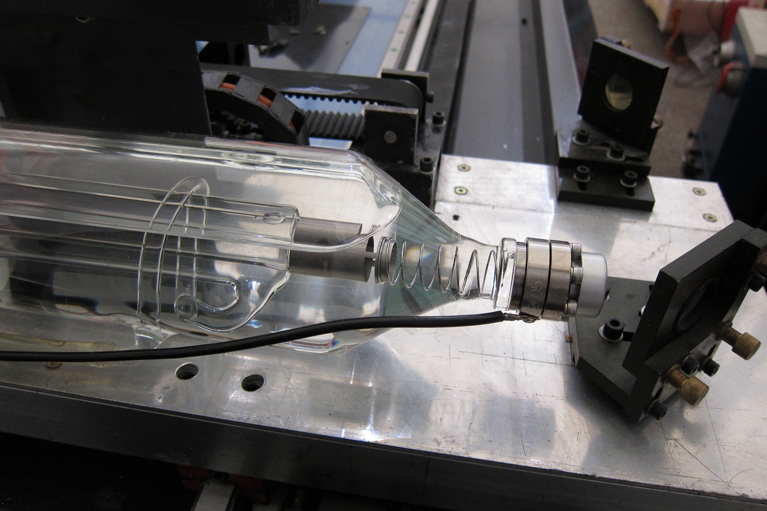

I just received a report that the 150W (A8) tube received cracked after a moment it fired (in Germany). What a big waste!
I explained to the customer that there were couple ways could lead to the crack toward to the tube.
1) When power up a laser, make sure water is flowing and filled up the tube without bubbles before firing. If not, turn off the power immedaite.
2)Even without water flowing during firing up, the tube won't be damaged much if power it off in seconds. However, do NOT water it immediate as the tube is very hot. You need to wait till it cooled down before filled up with water. Otherwise, cold water will crack the tube. Good thing for better timing.
3)During cold weather, room temperatuer usually lower than 20'C especially in factory. Then you need to be very careful to handle the tube in this area. For a small power tube, the condition wont' be as crtical as a high power tube. Like Bart said, laser tube is a device with low efficiency. It only output 10% of the the total power it consume. So, for a 150W tube, it's taking about 1500W power and wasted the energy as heat. Imagine how hot it would be even with seconds power on! Do not feed water below 20'C as a laser tube should be kept in 25~30'C or prefectly at 28'C. Or, you may want to warm up the tube by powering it with less power say 5%. Until the tube is getting warmed or until water is up to 20'C then you can start use it in full power
Now the customer seems not beliveing but there is not much I can do. I checked the weather there and it's 40'F (5'C)!! He said that he filled it up with water but he seems not seeing the problem, 5'C water is cold enough to cause the kill. I can only offer a discount for him to purchase a new tube. Even Raci would tell him the same story I mentioned above. I'm not trying to shift the responsiblity but the true is that I have nothing to do with the crack. The tube we sent was tested by the manufactuer before packing per our request. The tube either cracked from a shipment (customer recieved it in perfect condition) but it won't be possible it cracked itself if saftey concern was taken into account
A lot of people under estimate the 'cold effect' but only focusing on the heat issue or the how to cooli the tube but ignore the weather effect. It's wrong, they should consider how to 'warm up' a tube as well.
See the pictures he sent below.
