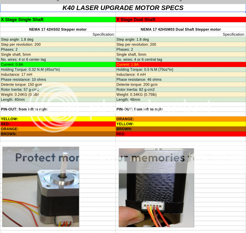

Here is the actual GOOGLE Sheet, for the picture below
https://docs.google.com/spreadsheet/ccc ... sp=sharing
OH MAN, i just noticed something , i really really hope is not a huge mess up on my part and you were probobly busy and did not notice that either
see the AMP on the Y STAGE IS 1.8 but the M415B Microstep Driver that you had shipped me with the DSP upgrade kit only go up to 1.5A
please tell me im not understanding something corectly, or did i just pretty much buy a useless motor in my case

Wire connection:
Yellow and Orange in pair to A+ and A- on stepping motor
Red and Brown in pair in part to B+ and B- on stepping motor
http://www.lightobject.com/NEMA-17-42HS ... -P747.aspx
Wire connection:
Orange and brown in pair to A+ and A- on stepping motor
Yellow and red in pair in part to B+ and B- on stepping motor
Hope this help... :lol:

Tech_Marco wrote:http://www.lightobject.com/NEMA-17-42HS ... -P723.aspx
Wire connection:
Wire connection:
nice i am going to try it out right now, got any insight on the UM settings and the what should the Microstepper be set at on the driver?

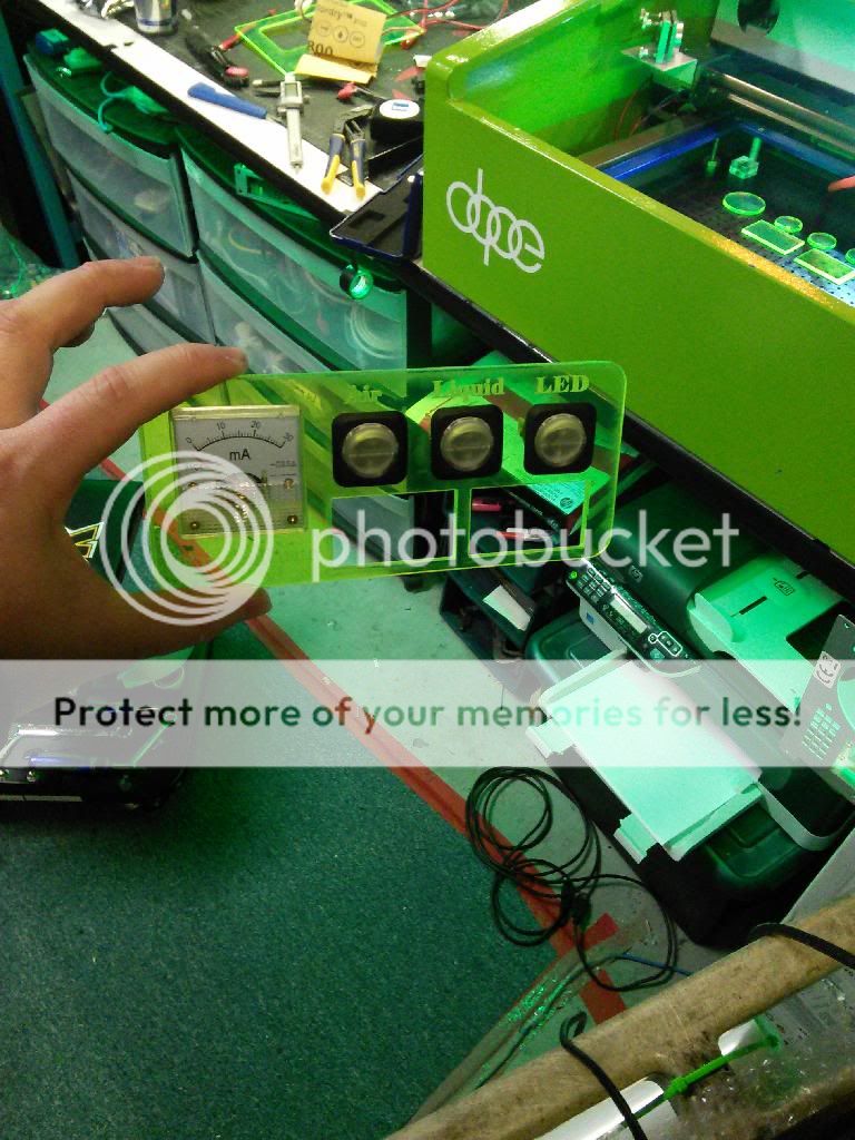

b.) Relocate the Temperature Read-out to the main Control Door(where the DSP Remote is connected to and emergency shut off,pictured below).
c.) Relocated all Three Liquid Cooling Switches to the Main Control Door. that way all the needed safe features are in one location, so that if anyone ever uses the machine that will be in front of everything they possibly need.
d.) Create a new Plate to Lay on top of the Main Control Door with nice rounded edges, because the new DSP remote bracket that i just cut is under the door because our metal is already nicely cut, i am not going to be able to get it as nice so i will make my acrylic nice, and what ever is under it, i can butcher to pieces, if you know what i mean. now depending on my drawings of how much room all this craziness is going to take i might add these two digital voltage meters make sure that my power supplies are not acting up at any point, add one for the motor power supply which is the 24 V, and then my water cooling set up is on a separate 12 V power unit, since i already have the little digital screens why not, throw it in there.
2. Install the Analog mA meter that originally came with the "cheap k40 Chinese laser engraver". Mainly doing this as a piece of mind for security knowing that i am at no point going to be doing harm to the laser, and who ever is around it.

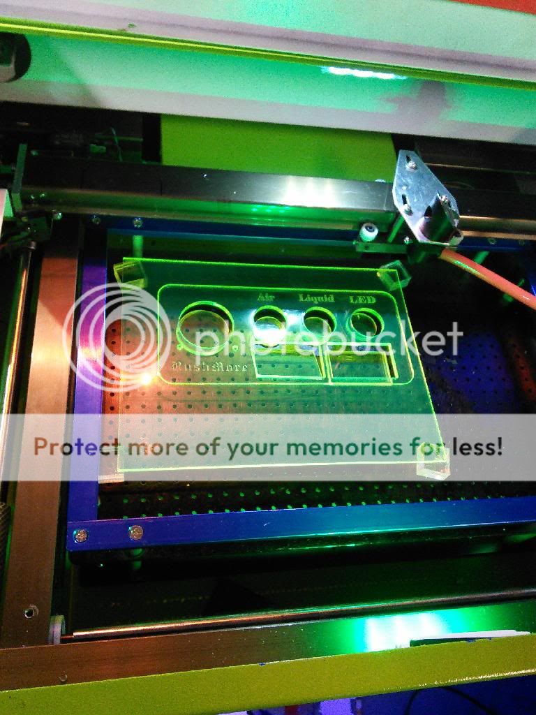

Started working on the second interface plate for the laser which will be on the same door as DSP LCD
Here is how it looks.
I'm just waiting to get my two Temp Read outs. One for Liquid temp and one for Ambient
