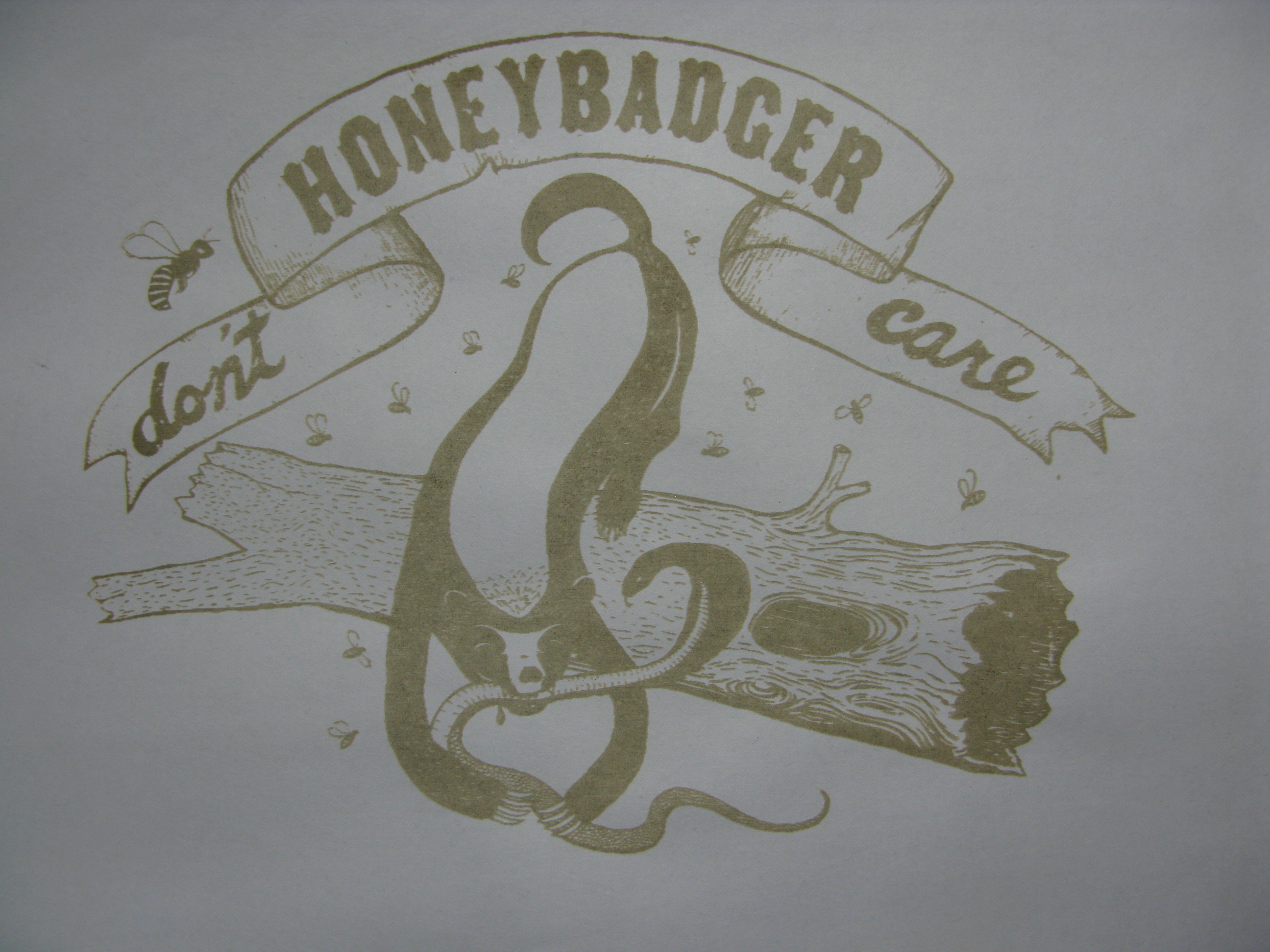

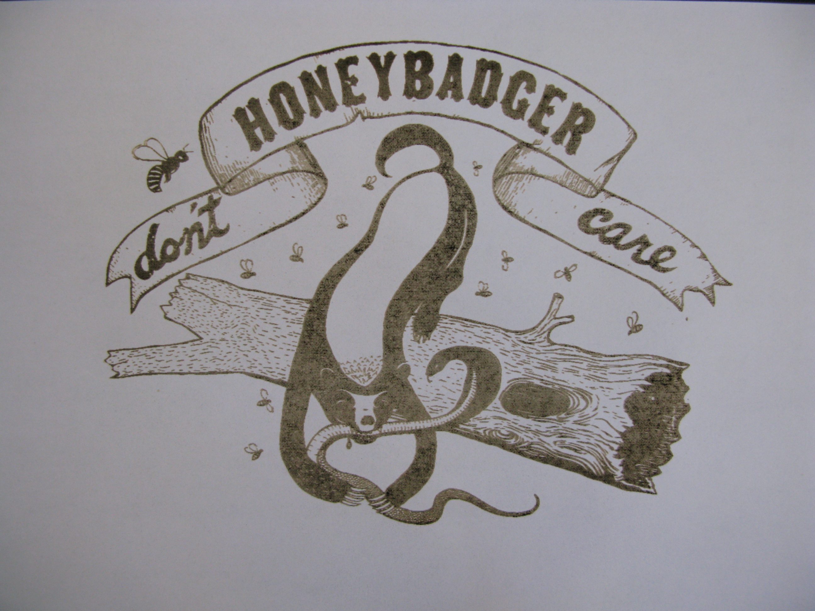

Re: New Issue - 1/4" Cut at start of every job
mattrsch wrote:The cut issue has reared it's ugly head again. I was running a bunch of small scale engravings on a new material to decide on what speed and power settings I wanted to use, and had no issue with any of those. The laser was in soft layer params controll mode for the first engraving, and in LCD Panel mode for the last 4 or so. Once I was satisfied, I scaled up to full size on the image and added a box for a cut line. I downloaded this to the laser. After the download I changed back to soft layer params before I ran the job, and it made the little 1/4" cut.I have uploaded the file in case you would like to look at it.
Idon't have an issue to engrave it. See attached image and YouTube video
I shrinked it "195mm x 176mm" as my machine can't fit your image
http://www.youtube.com/watch?v=aOPZ4ecsG8I
mattrsch
- Posts: 20
- Joined: Sun Dec 11, 2011 8:15 pm
I have not been able to repeat the issue. I will try to get it to repeat again this weekend.Tech_Marco wrote:mattrsch wrote:The cut issue has reared it's ugly head again. I was running a bunch of small scale engravings on a new material to decide on what speed and power settings I wanted to use, and had no issue with any of those. The laser was in soft layer params controll mode for the first engraving, and in LCD Panel mode for the last 4 or so. Once I was satisfied, I scaled up to full size on the image and added a box for a cut line. I downloaded this to the laser. After the download I changed back to soft layer params before I ran the job, and it made the little 1/4" cut.I have uploaded the file in case you would like to look at it.
