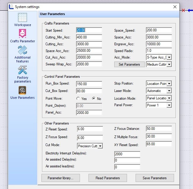

Any revision updates yet Marco? Also, what is with the job timer? I am getting numbers way off from what it actually produces. It almost always says it's going to take way longer than what it actually does. Is there something I am doing wrong before I run the "Simulate" feature?
Lastely, I know you gave me a few set up numbers for that 1200x900 gantry, but is there anywhere I can find all of the optimal setup numbers on the forum? I ran most of what you said,
On another note, I made a trophy for the food truck battle here in VA, then I configured our machine with a hinged drop door on the face so I could do larger object that wouldn't fit in the bed under normal circumstances. I was ask by a local restaurant to etch a 2x8 foot solid redwood sign. It turned out excellent and they where very pleased! My next project it going to be building a scale model airplane on the larger side. I am almost finished drawing the plans and acquiring the wood needed
however I don't know what you mean and can't find anywhere for Space or Cutting_Jerk", is it called something else? There are some things that I feel could still get better.Microstepping: 5000~6000, X acceleration: 8000, Y acceleration: 4000. X speed: 650, Y speed: 400. If there is a setting for Space_jerk or Cutting _jerk, I will put 20,000 and 15,000.
Re: Corel Support?
There is not much update for plugin. All they said was that the software remembered what was setting from last color it used; cut or engrave.
Space_jerk or Cut_jerk was actually from the different controller card X7. It means "The acceleration of acceleration.."
See picture I attached. More or less you may want to tune the gantry you have because different machine acts differently even with the same parts used.
