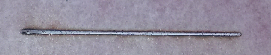

The farther away you get it gets a little worse. I've tried all four corners and the middle. Not much difference.
As stated before, when it first starts it's cut at 1mm, it cuts through the 1/8" plastic for about 1/16" to 1/8" then it just barely marks it.
Not sure about the no problem with tube. I can't seem to verify that in my mind.
Look at this pic. This was done 12" away from mirror #2 with NO air assist nozzle. That's half the distance of my bed. Hope you can see that the cut starts much deeper than it finishes.

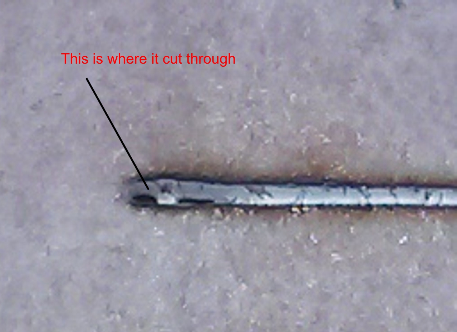

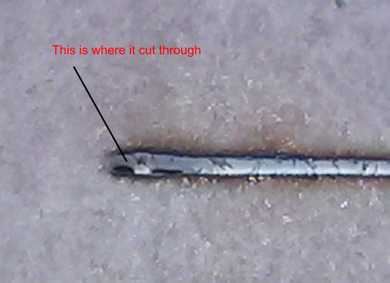

The close up shows just the first part of the cut. The black in the cut is where it cut through.

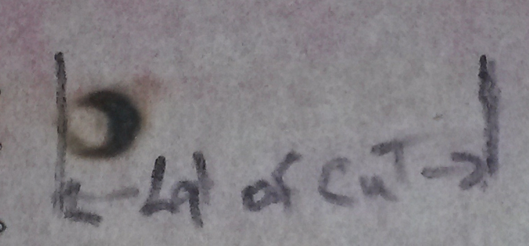

Here is pic of the pattern without focus lens. You can see that there is a scorched part where it starts, then nothing. It seem to be losing more power as we go. I now have to hold the "laser" button much longer to get it to scorch a piece of tape to check alignment.
