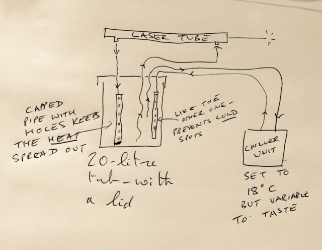

I tried a 120mm radiator with a mains-powered fan: useless.
Then I tried a six-pack/camping fridge (240vAC and 12vDC - it was cooled by a Peltier-effect cell), took the door off, lay it on its back, sealed the gaps and used it as a reservoir: hopeless.
What I ended up buying on eBay was one of these: Arcadia Aquarium Chiller 500ltr 250w AT250 Summer Fish Tank Water Chiller; I've never looked back. I always run the chiller and circulating pumps for a while before firing up, so as to avoid thermal shock.
Here's a picture of the setup - I've omitted the pumps because a) the picture is cluttered enough already and b) if you can't work them out for yourself your mummy shouldn't have let you play with lasers in the first place!

they are way to expensive for a water chiller, the system I use is a 20.000 BTU window AC with the radiator and it holds the room temperature at a normal ;level and the same time it cools the laser water.
the window AC and the radiator cost about the same as the aquarium chiller .

Not here in the UK they don't Walt!
Our climate makes domestic AC units virtually unheard of and most of our homes and work environments sit at 18-20 degrees without much help for most of the year.
Besides, I didn't think £100 ($160) was too bad a price to optimise tube performance AND lifetime!

by NickWL
I did!
But I waited about 6-8 weeks just watching aquarium chillers on eBay and pounced when all the stars were correctly aligned!
£100 plus an hour's drive to Bristol (carriage would have been a stinker) and same back.
