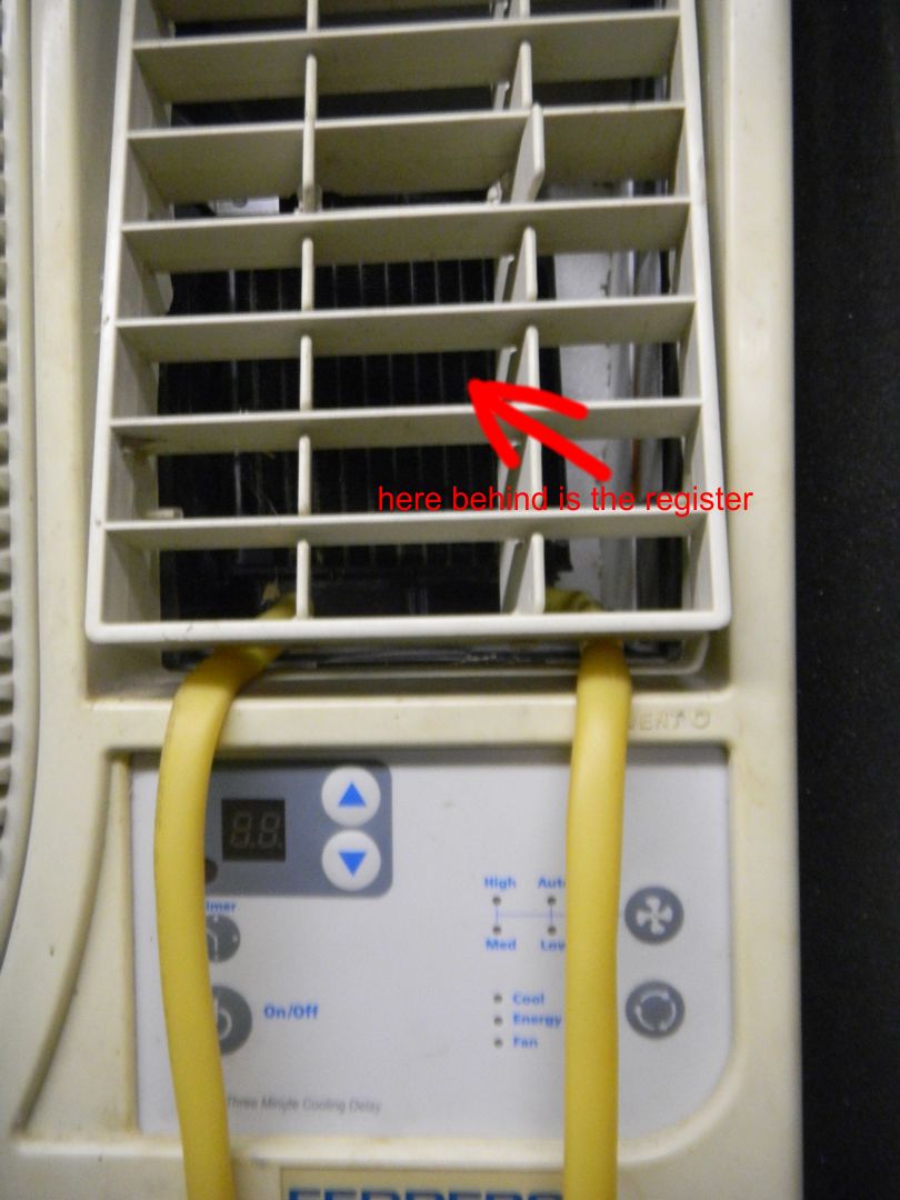

I use a 120 x 120 mm evaporator which is inserted in the outlet canal of a AC window unit.

that's why I now using my window AC where I installed the radiator inside the outlet canal the way that all the AC cooled air has to blow thru the radiator see picture.

then the only way is to use a peltier element with a big heatsink from a old computer and use the fan to extract the heat from this and put the radiator on the other side.
yes I am surprised too that most guys don't even watch the temperature I try to tell everybody since years they need to watch the temperature and cool the water, but they also believe that's just mumbo jumbo and then crying if the tube is gone.
Toasty wrote:Hmmm, well, I'm going to have to figure something out. I don't have much a problem with engraving but those once in a while cutting jobs are gonna kill my tube if I don't figure out a better way to keep the temps down.
I'm really just shocked at how little that issue is talked about when it comes to the k40. From what I've seen almost no one is running any kind of cooling other than water in a bucket.
The window ac unit idea is great but the shop I have has central air and no windows near the laser so I won't be going that route.
