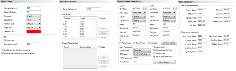

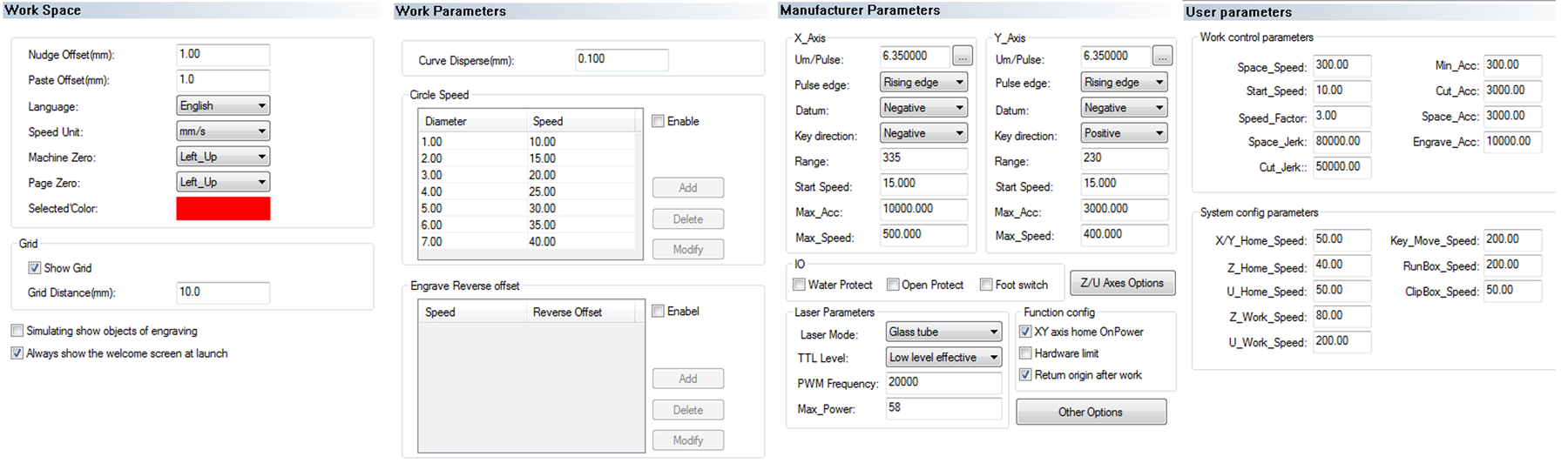

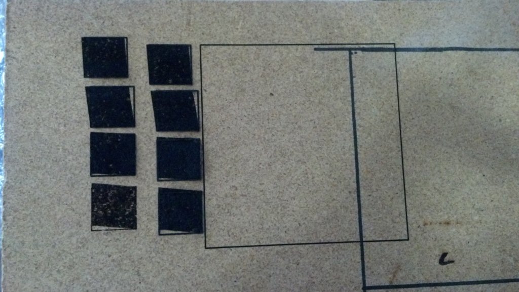

Hey guys after trying all of the suggestions here I am still unable to get this to work correctly. Here are my settings and a picture of the the cut after engravings that I tried to do. I did check that the Um is set correctly, and my 100mm square measures out perfectly *almost*. It is about .33 mm off on both axis. So nonetheless I am at a loss on how to fix this. Any help would be greatly appreciated.
On the engraving/cutting picture, I did a multitude of settings.
Each square is set to 10mm/s/90% for cutting and 150mm/s/70% for engraving. The left side is falling edge and the right is rising edge. Then from top to bottom it is X_swing, X_unilateralism, Y_swing, Y_unilateralism.
As you can see none of the settings work right. I did not mess around with the max_acc or max_speed settings.
