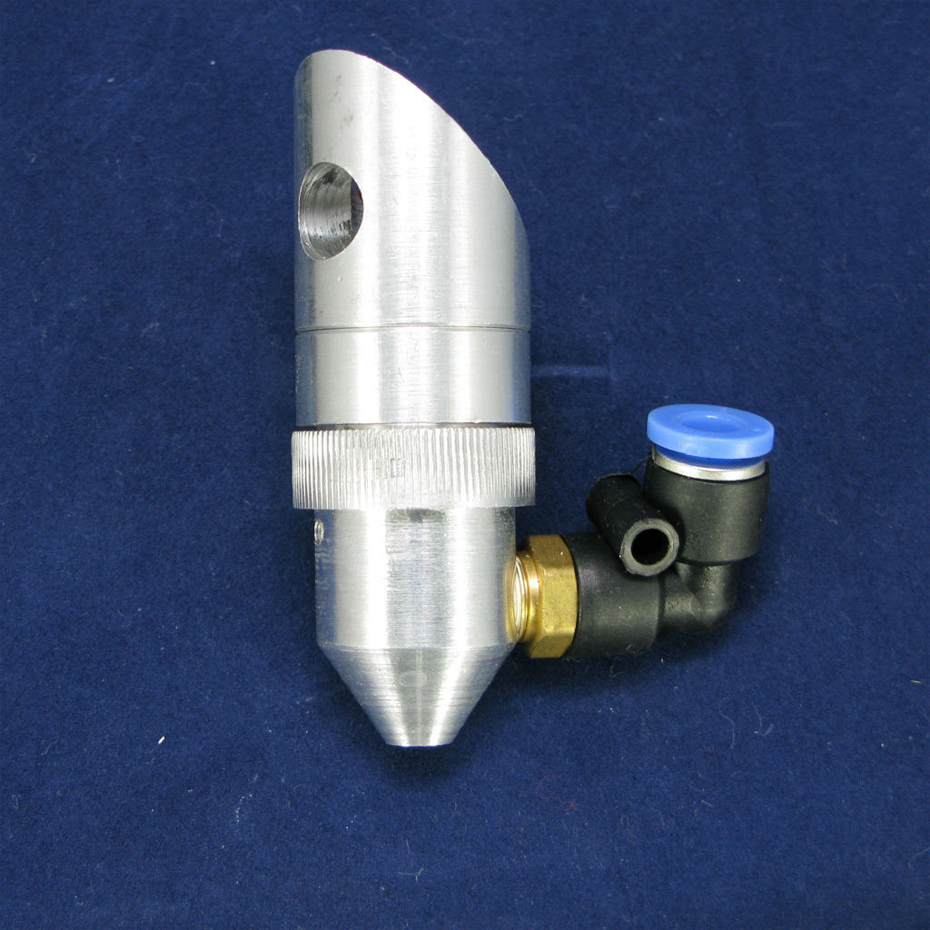

I do have the air assistant laser head, the connector, and the tube. It's desgined for the K40. However, there is a few screw missing on the aiir assistant laser head and I need to find it from handy shop.I'll post some pictures here later

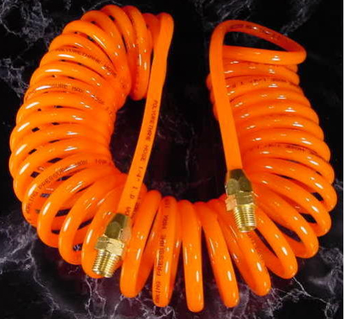

Some auto store have air tools that use the small coiled air tubing. You might want to try them and see what they have. You can also search eBay for them.
Here is a link from Australian eBay for something like you are after.
http://www.ebay.com.au/itm/1-4-x-25-foo ... 53ea4a30c4
Re: Help with the DSP AWE-608 2012
Picture shows what I'm carrying.

Those 1/4" hoses are far to big and stiff to use, they would add too much drag to the laser head assembly. I have one in the garage on my compressor. Actually I think the surgical tubing I'm using is to big. I'd much rather have a coiled 1/16th ID hose, but I've had no luck finding one.
I did order the hose that Walt link which should be here in a week or so. I'll let you know how that goes, otherwise I might just have to bit the bullet and but on a cable chain.
You don't need to use the coil tube but staight type tubing instead. Coil tube looks short but it's long and the weight of it may cause some 'over-loading' on the K40 . Remmeber that K40 only comes with two small 42series motor.
I haven't posted the air assist laser head yet as I need to find two tiny screws that supposed to come with. It's used to lockup the bottom part of the laser head. Without it, the cone part will fall off. Been talking to the supplier but they have louzy customer services and ignore my request. So, I'll find another supplier to make it in the future.
By the way, I have better ZnSe focus lens for the K40. If you found that the cutting power is dropping, you may try mine. The ZnSe that comes with the K40 is very low grade type. I'll shoot some picture for the comparsion.
