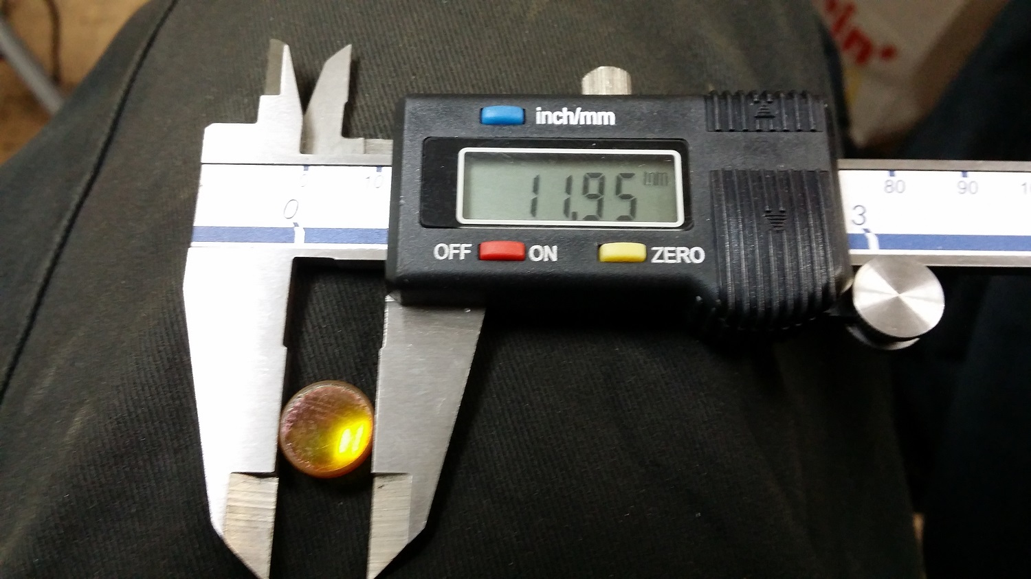

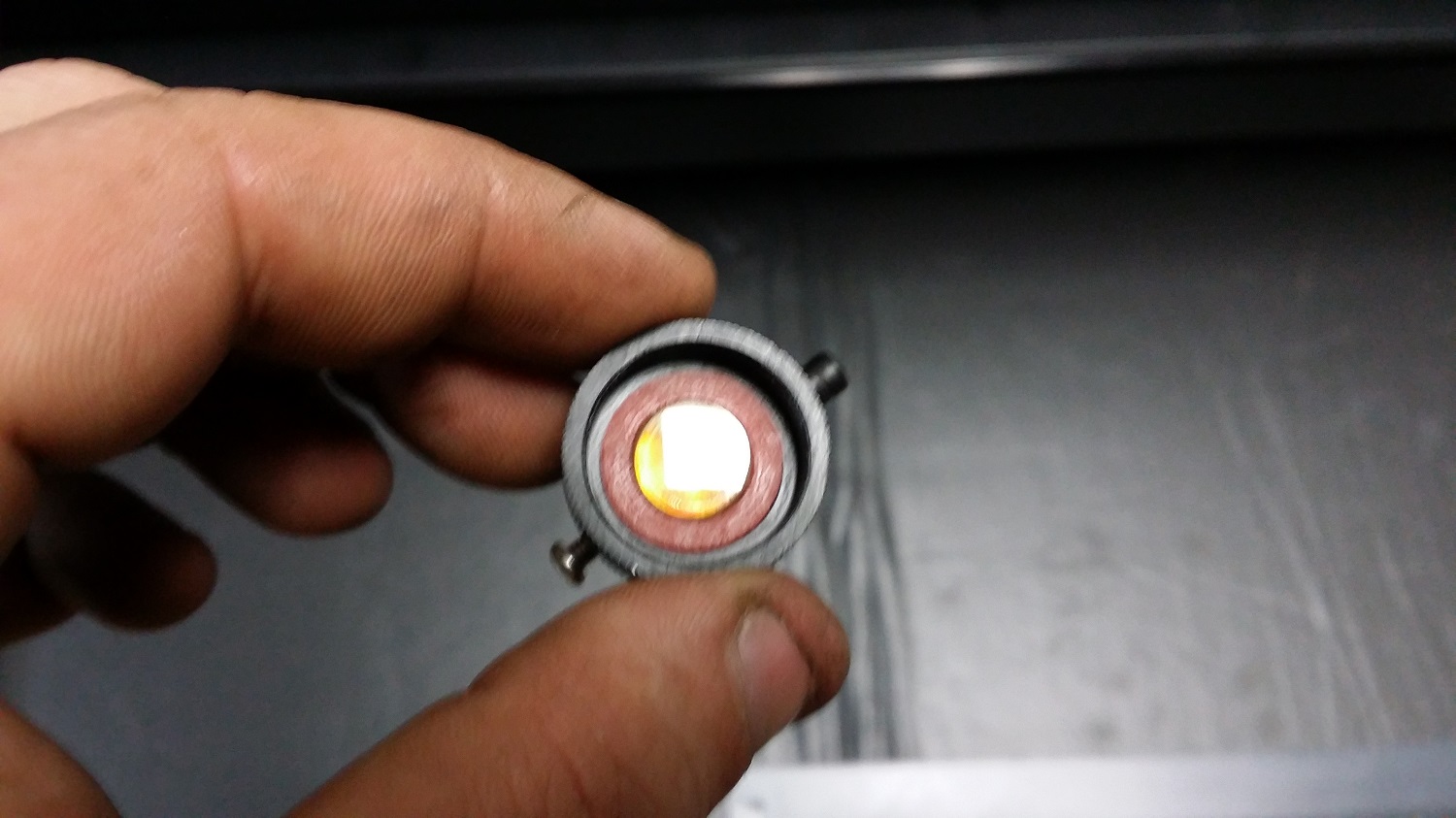

For what it's worth my K40 came with a 12mm lens
I'm going to try and use some spacers around it so it doesn't move within the new head. If not I suppose I'll be getting an 18mm lens soon

BrianJenkins wrote:For what it's worth my K40 came with a 12mm lens
Mine was 12mm also....I made a spacer real quick on my 3D printer....I can post the stl file if you want it.....

Same idea but no 3d printer...
I took a nylon washer and cut it down on the lathe, then enlarged the hole. Does make it easier to clean the lens, lol.
