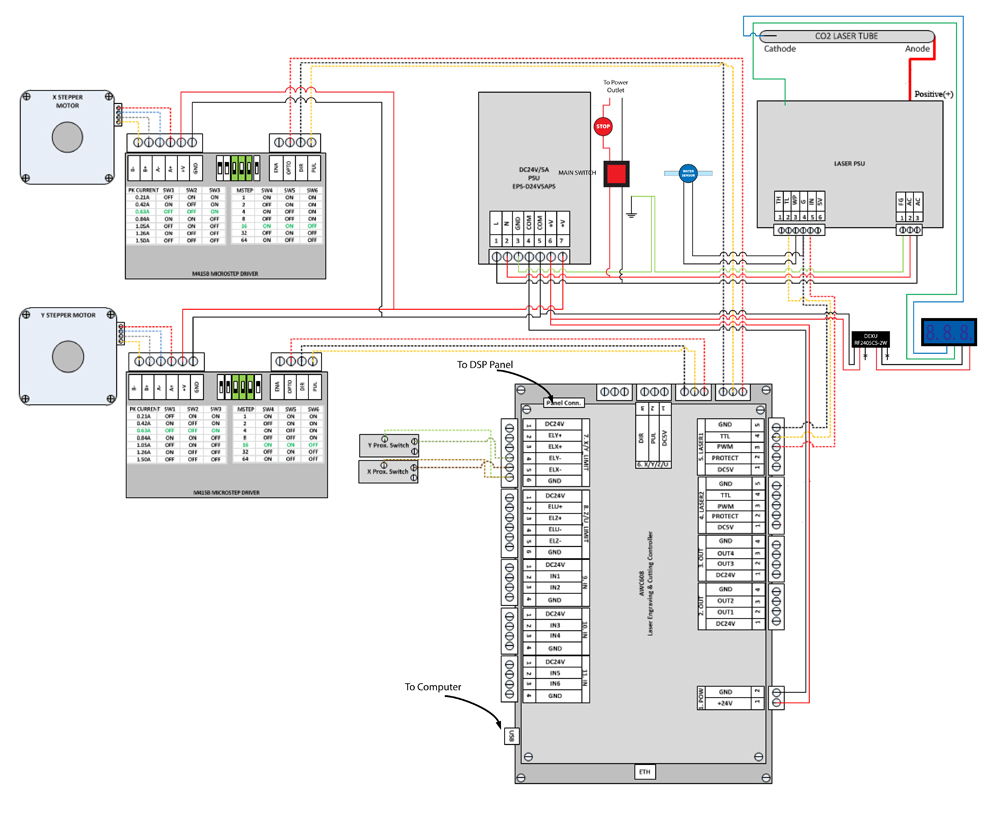

However, now that I've wired in an ammeteraccording the wiring diagram, I'm only getting max 7.8 mA.
Rather than pop the power supply open and start screwing around, could someone tell me where the potentiometer on this laser power supply is?
I notice there's a little screw that kind of looks like a potentiometer on the back of the ammeter. Can the current be adjusted there?

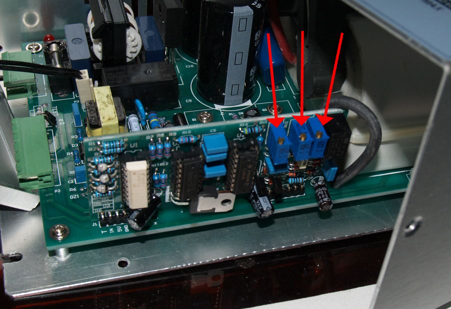

Now I've got the opposite problem: I need the amperage turned way down. When I press the "test" button for a second or two, I read around 23mA. I did a test cut at 98% max/97% min power and my ammeter read at 27.4mA for the entire cut.
I cracked open my power supply to look for a potentiometer and found what I think are what I'm looking for. Problem is that I found three of them.
Which of these (if any) get turned to lower the current going to my tube? If none of these get adjusted to lower the current, how do I go about doing that?

You don't to do anything on those VR. To limit the peak current, you go to Option -> System tem setting -> Manufacturer parameters -> Max_power
In your case, I'll put down 65%
By the way, the purpose of those VR : V1, V2, V3 where V1 is next the black little relay, the set up is as following:
V1: 100% output current when input is max (5V signal)
V2: 50% output current when input is 50% (2.5V signal)
V3: Frequency
What I did was to use a DVRM meter to check the voltage at the phoenix terminal Gnd vs IN, then inject voltage 0V to 5V. For example, if I want the max output is limited to 18mA, then I set the output to 9mA on V2 by inputting 2.5V to the Gnd & and IN
Then, I inject 5V to the IN and turn the V1 to output until it reach 18mA. Usually we don't do anything on the frequency port as it is used for the AC power frequency response like 50Hz in China and 60Hz in USA
But, bottom line is that it is NOT necessary to play around without those setting Unless you didn't get output or out is extremely low like 4~5mA when drive the PSU in full power (100%)
Hope this help to clarify the mysterious of those three 'VR'
V3: Frequency
