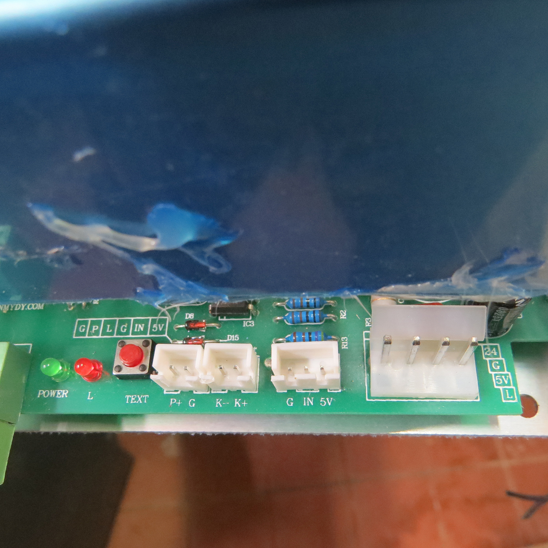

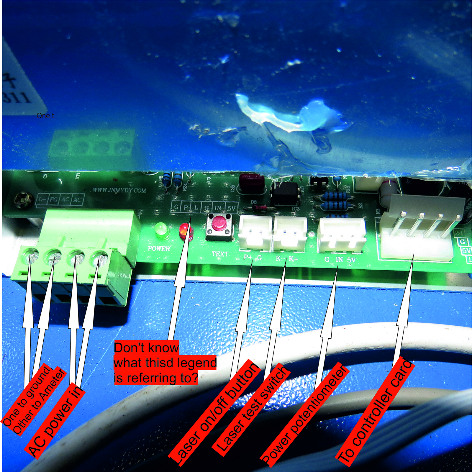

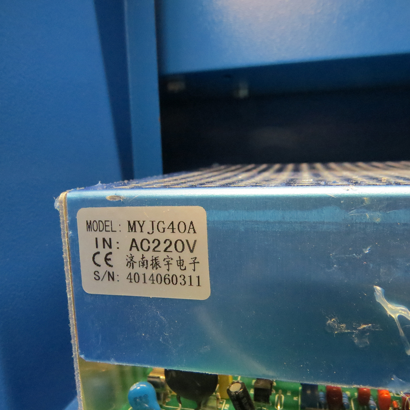

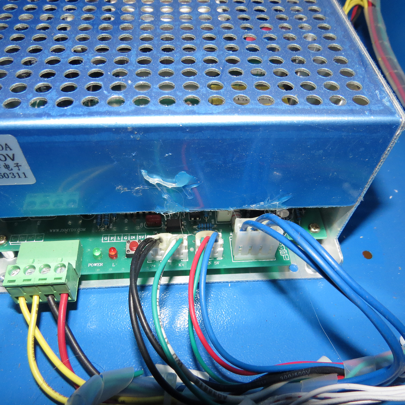

Hi Pars, thanks for your input, the p/s is the same as the one at the begining of this thread. This is the link to the manufacturer. http://en.jnmydy.com/products_detail/&productId=22.html Its a different model number to mine (MYJG 40A) That one (MYKZ 40W) but it looks identical to mine, I guess its just an upgraded model of mine. Heres some photos I took.
A bit more info I've worked out.
Re: Purchased DSP - Do I need to purchase PSU too?
Connection:
Connect P+ and Gnd together
Connect K+ to DSP TTL
Connect IN to DSP PWM
Connect Gnd to DSP Gnd
Leave the right most connector for nothing. You can get DC5v or 24v from this port
For the AC power connector:
Laser negative, FG, AC, AC
Regards,
Regards,

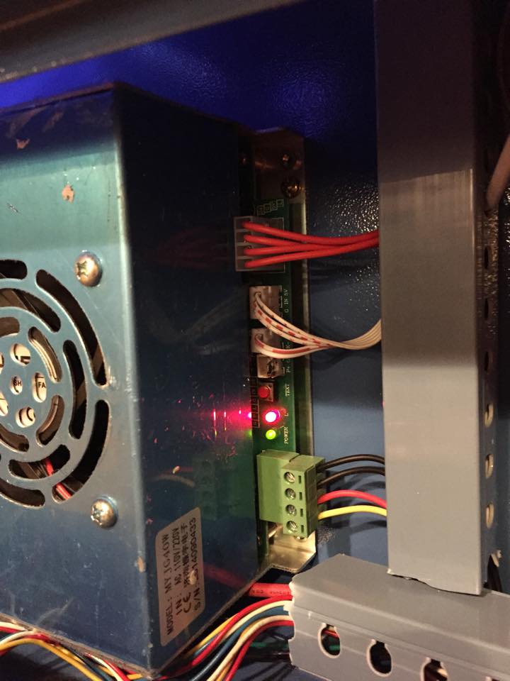

I've wired everything up according to Marco's instructions, but the laser seems to be firing at full power.
I've double checked my wiring, and it's right.
Any suggestions?
Any suggestions?
