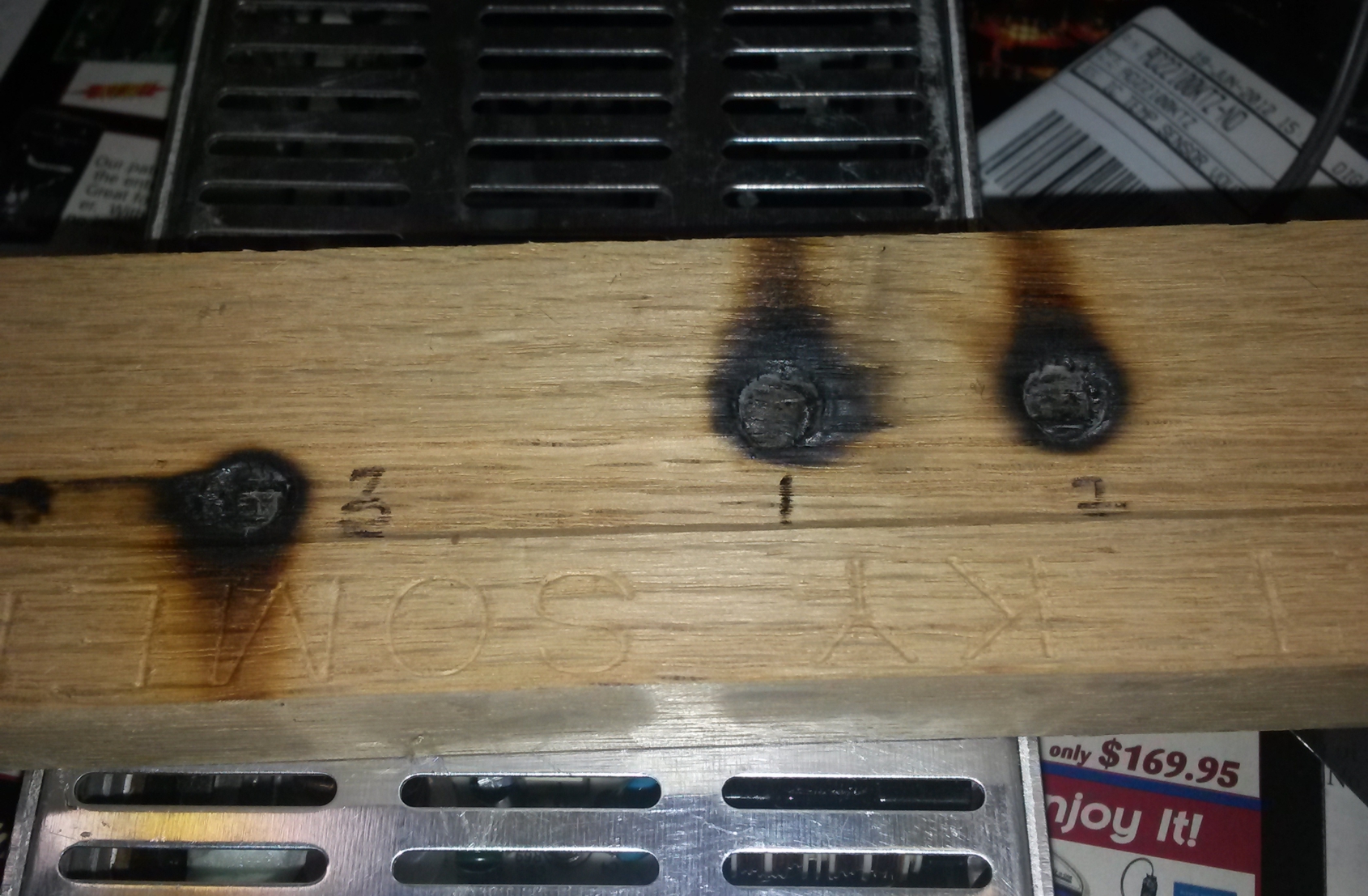

I think there is 'voltage leaking' somewhere if the tube is running fine. When you did the 15 min test, did you test the fire power right before turning it off (at 15min). Was it still able to burn good? What I mean is that whether the laser output stable or not from min 1 to min 15? I know that you got a nice burn hole but you don't know when did happen. Could be the 1st min and nothing after the 2nd min or it burn well continuoulsy. Light up on the laser tube (internal) doesn't mean there is output.
So, I need you do do one more time. Power up the tube and test the firing power right before turning it off by move the wood block 1" away. That way, you can tell if the beam is full or "power" and be able to cut.
If it is good, that means something wrong with the power supply or the cable
bobkeyes
Posts: 46
Joined: Sat Feb 02, 2013 2:26 pm
Re: Problem with laser power
Post by bobkeyes »
3 burns at 18 mA. 15 min each.
I don't see it being the power supply because it never wavers on the 18 mA it's supplying. Anyway here's the pic.
Pulled out HV cable. I see NO problem there.
So, there is no problem on the laser tube and the laser power supply. I'm curious how come power get less and less when doing cutting job. When the problem happen (less power), was it doing on the same spot or in different location? Did it make difference when doing cutting closer to the corner (home) and further away from the home? Try doing cutting in different location.

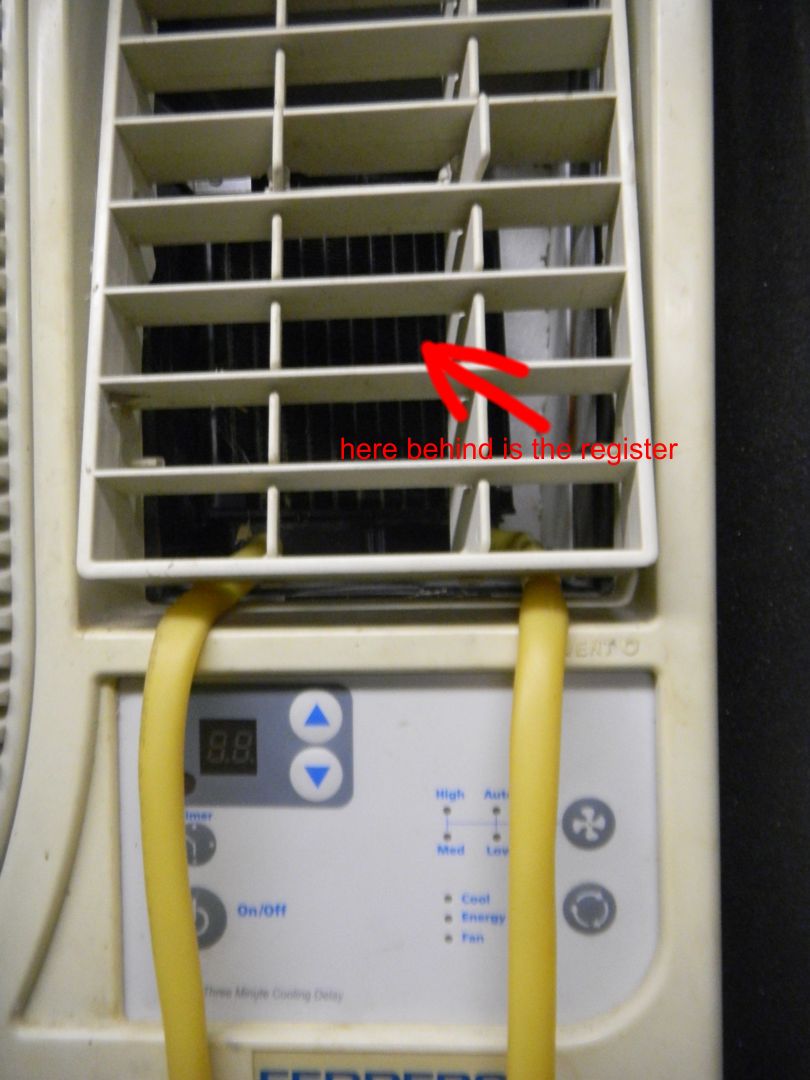

the only point where the cutting power looses power over time is the water temperature.
put your temperature sensor about 3 inches away from the tube inlet directly on the water tube and watch
the temperature.
if you have not additional cooling power like peltier or chiller or like me with a A/C unit and radiator the water cooling will not be enough.
during cutting with 18mA the water temperature will rise about 8 degree F within 3 to 5 minute and with every degree rise the cutting power goes down about 10% .
believe me I have learned my lesson and paid for 3 tubes befor I got this now my tube has 1,640hours on it and I still can cut 1/8 with 5mm and 48% and 1/4 with 3mm/s with 51% power,
here is a picture from my window A/C setup
