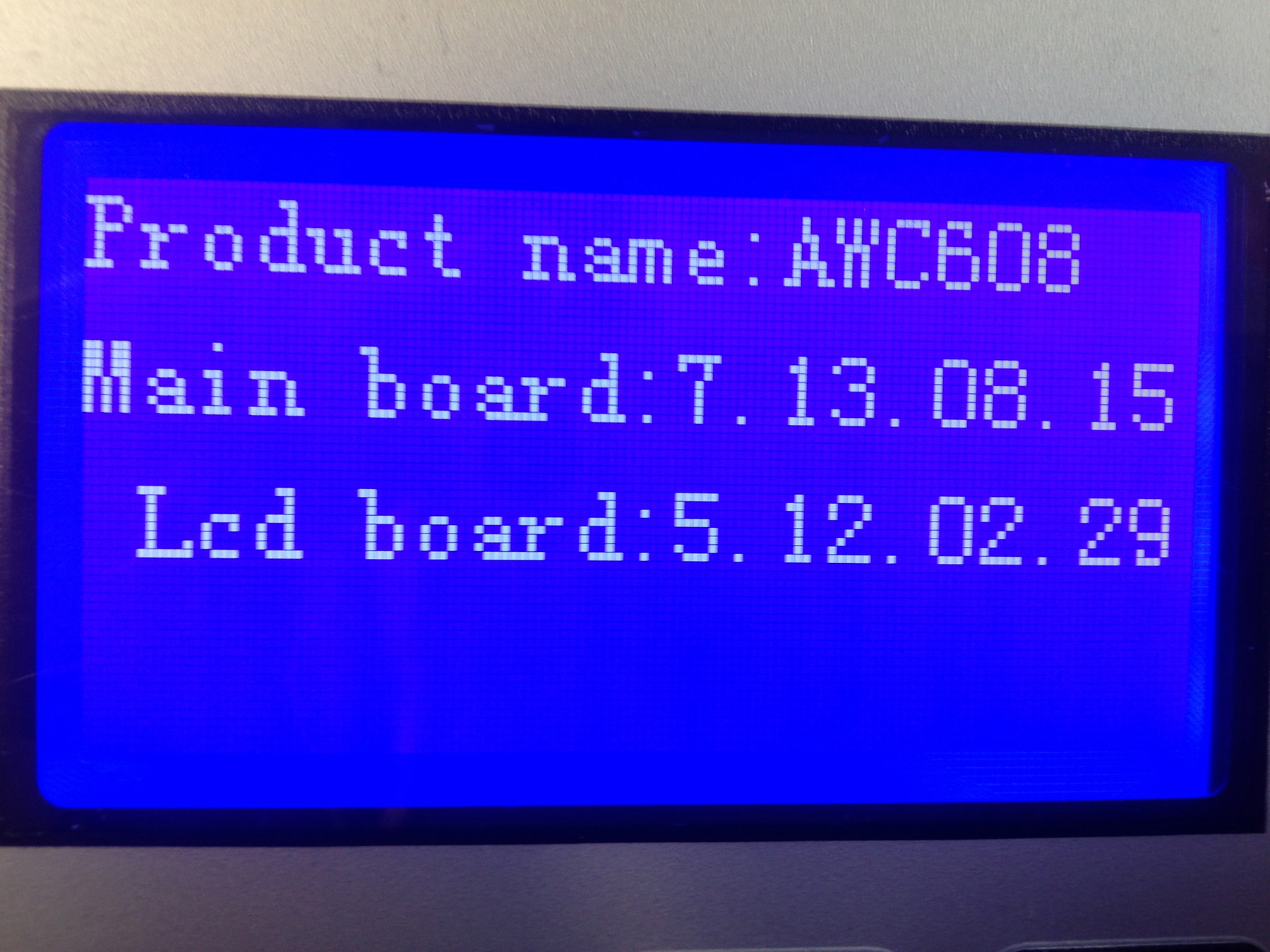

I am running LaserCAD V6.71 but see in he forums that someone asked about LaserCAD V6.81. Also is the firmware correct on my controller(attached is photo of screen). Also is there a factory Default that i can go to that might fix this problem?
Tech_Marco wrote:I doubt it that is a faulty DSP controller. But if you want to, you can send it back for me to test it. If is defective, I'll ship you a new one for you. But if not, you need to pay for the return shipping cost.
Send me order# and I'll issue you a RMA#
Version.
Version.
Re: Wavy Cuts and Bad Etching
The OS is current. Even if it's old won't give you any trouble like that
