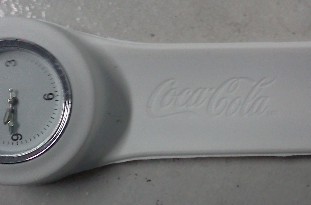

I attach a photo of the finished product.

IT'S ALIVE!!! ALIIIVE!!
- rubber snapon watch.jpg (11.59 KiB) Viewed 2243 times

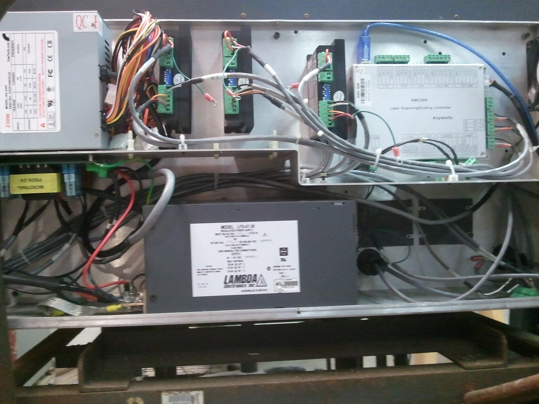

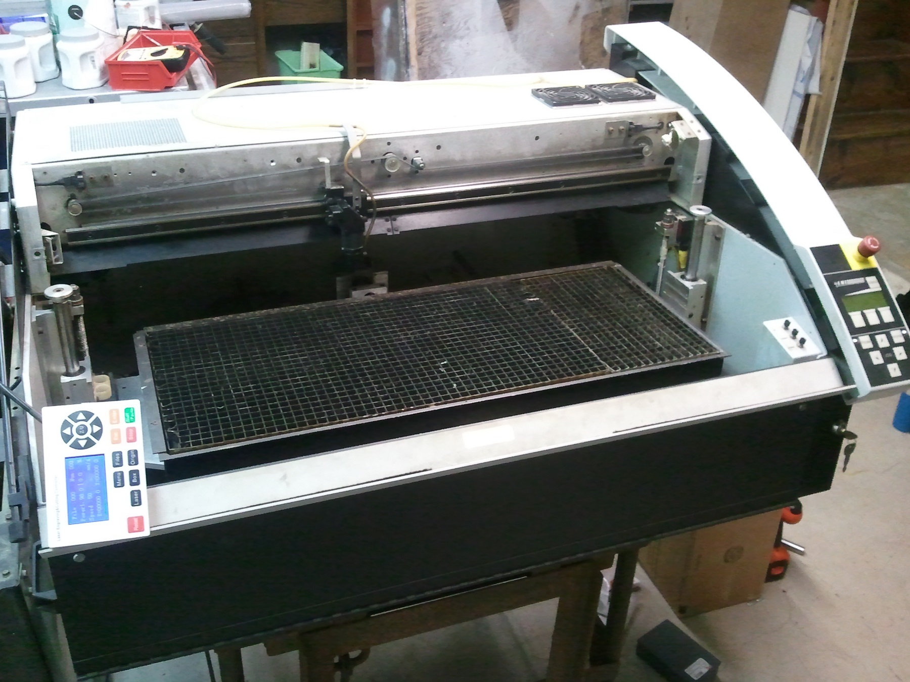

It has been awhile since I have been able to work on my laser. I checked out your video and it looks like you have it all figured out. Here is what I have so far. X-850mm x Y-280mm x Z-150mm.

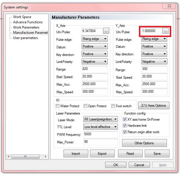

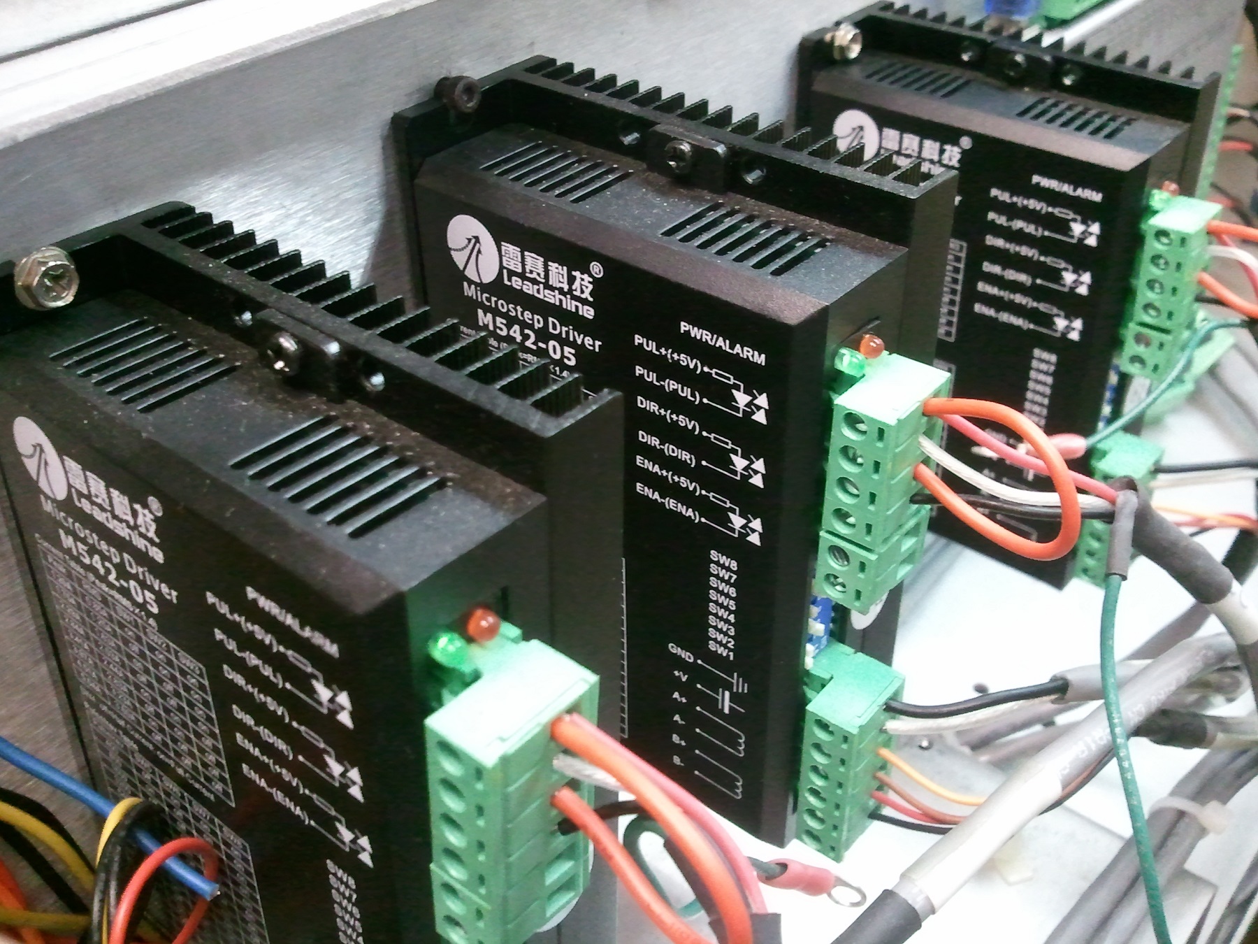

I have every thing wired up and finally got all of the stepper motors working (sort of), but I have a problem changing the um/pulse for the y and z axis. I read the parameters, change the um/pulse using the calculator, hit save, and press reset on the display. No changes are noticed and when I read the parameters again, they change back to what was there before. Much like Glenn from this post viewtopic.php?f=8&p=8899#p8899.

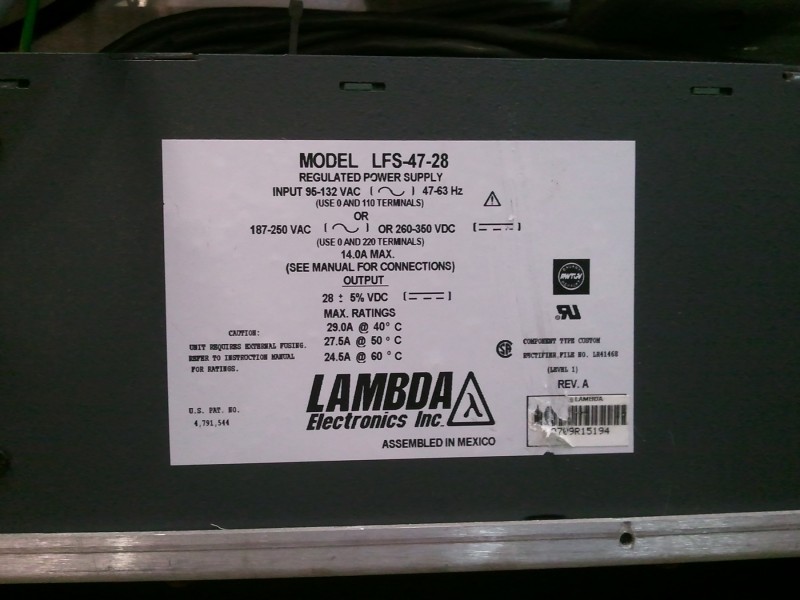

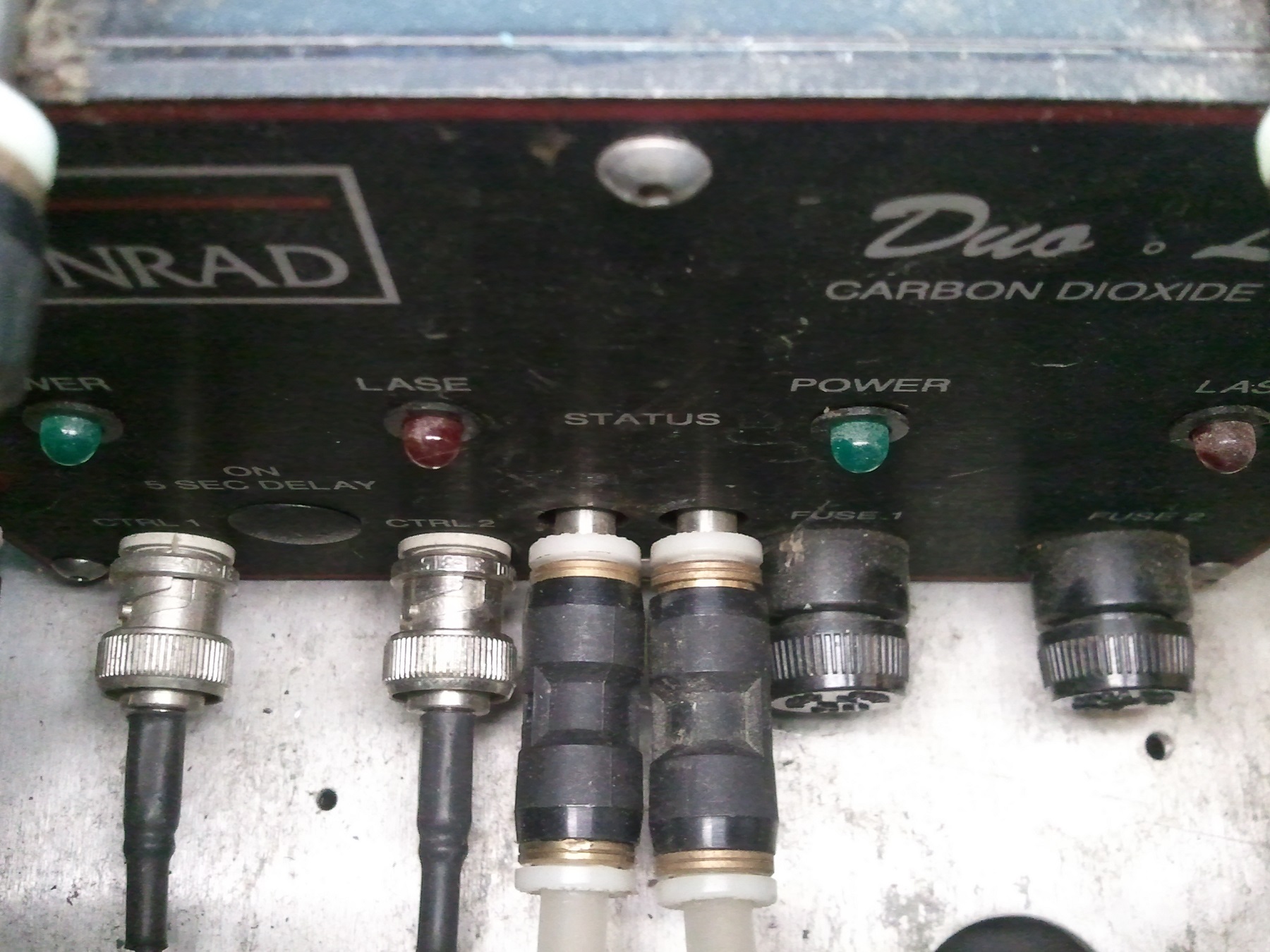

I am also not sure what I need to change, but the Z-axis cuts out when moving up if I hold the jog key for too long. Is my acceleration too high or too low? Should I change the micro-stepping setting on the controller ore will this all go away with the correct um/pulse setting (if it would work). Here is the laser power supply. It provides constant power to the laser and the BNC connectors below are what I have connected to the TTL pins at laser1 and laser2. I am hoping that both laser1 and laser2 will fire at the same time when lasing. I have the frequency at 5000 Hz for the "tickle/pre-ignition" signal required all the time while running the laser.
Every other parameter seems to change just fine though. Marco, please help me with this. I updated the controller to 130922v7 just to see if that would help.tbirdglenn wrote:When I go to Engraving acceleration it displays 10,000. When I click Read the acceleration goes to 1000. I change it to 10,000 and save and OK. I open parameters again and it displays 10,000, click Read and it goes to 1000. It doesn't save the 10,000.

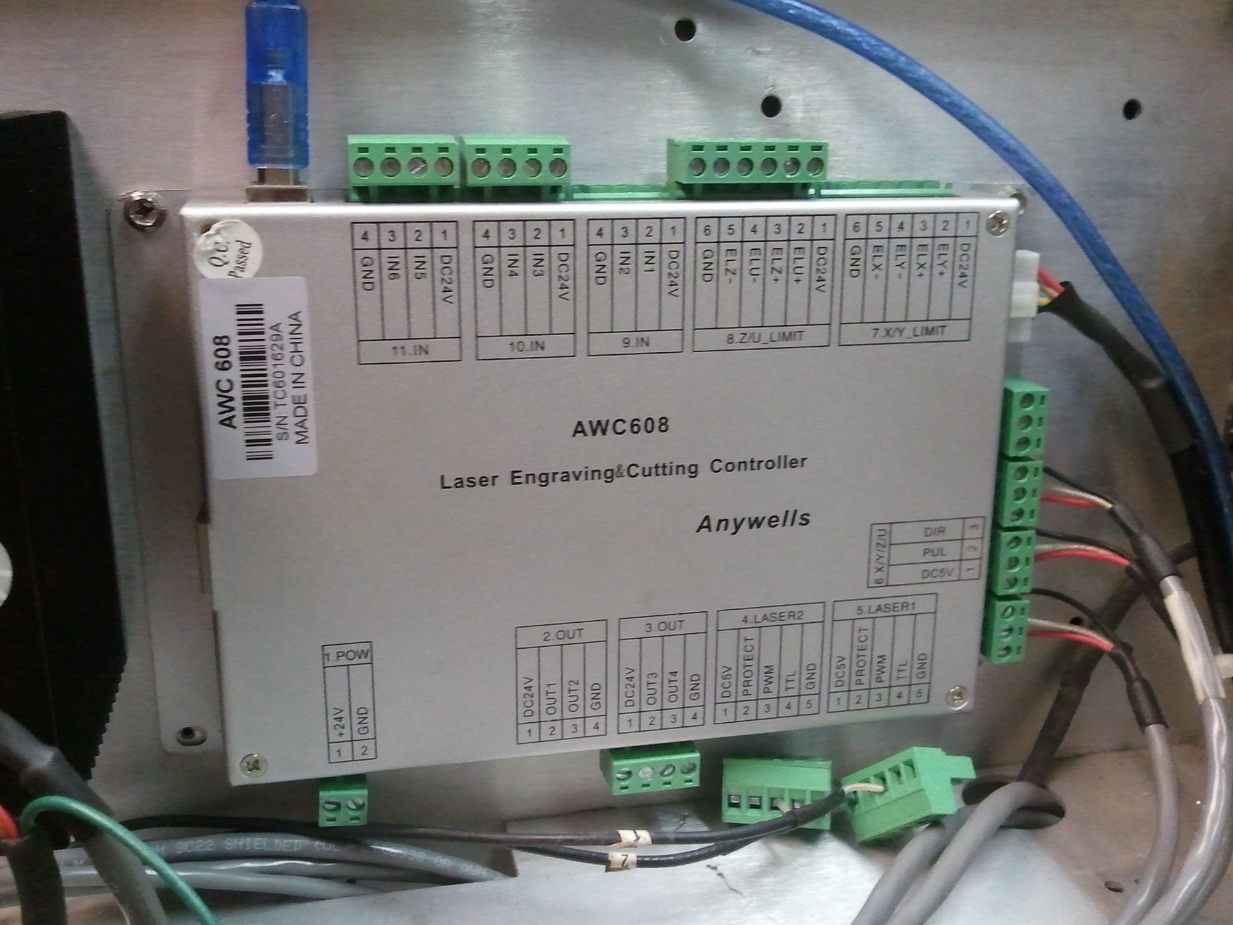

I've just posted my order for a AWC608, I believe I can pick it up on my way to ARA later this month, after that I'm gonna start building my 2nd gravograph machine, will keep you posted, as always.
