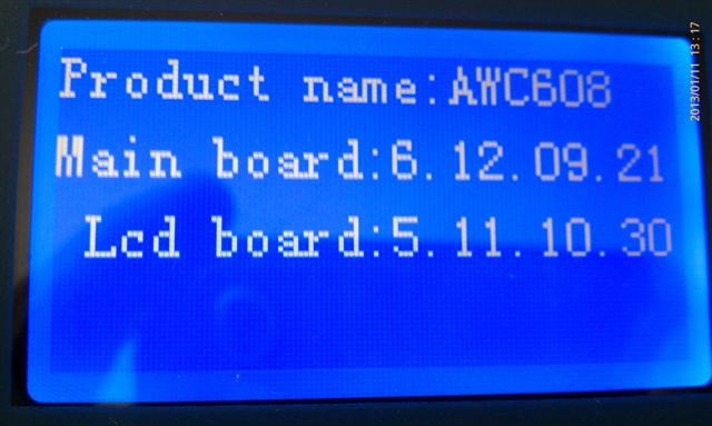

I have LaserCad v6.27 and just upgraded (or attempted to upgrade) my DSP 2012, I tried v1, v2, v6, v7, v8. The only ones that would load and upgrade were v2 and v6. The memory stick I'm using is FAT32 format but it's only a 256mb but has been working perfect for transferring files.
Below is a pic of my current DSP screen after loading v2 then v6, is v6 high enough to run LaserCAD v6.27 properly ?

Yes. V6 is your version number so you can't use V7 or V8

I did a few dimensional test cuts and all turned out perfect, it's nice to finally have PPI too !!! I'll try an engrave file tonight.
