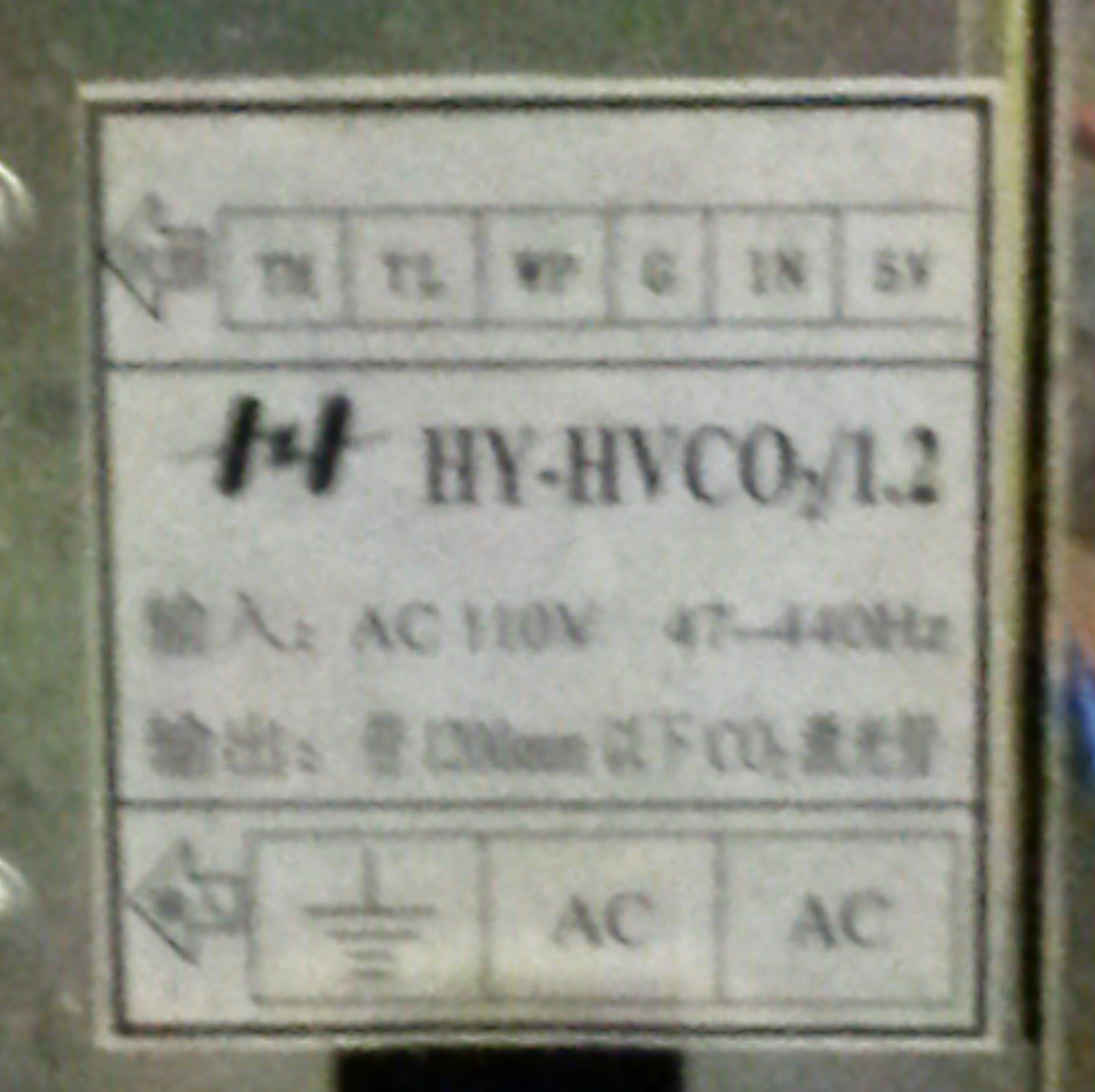

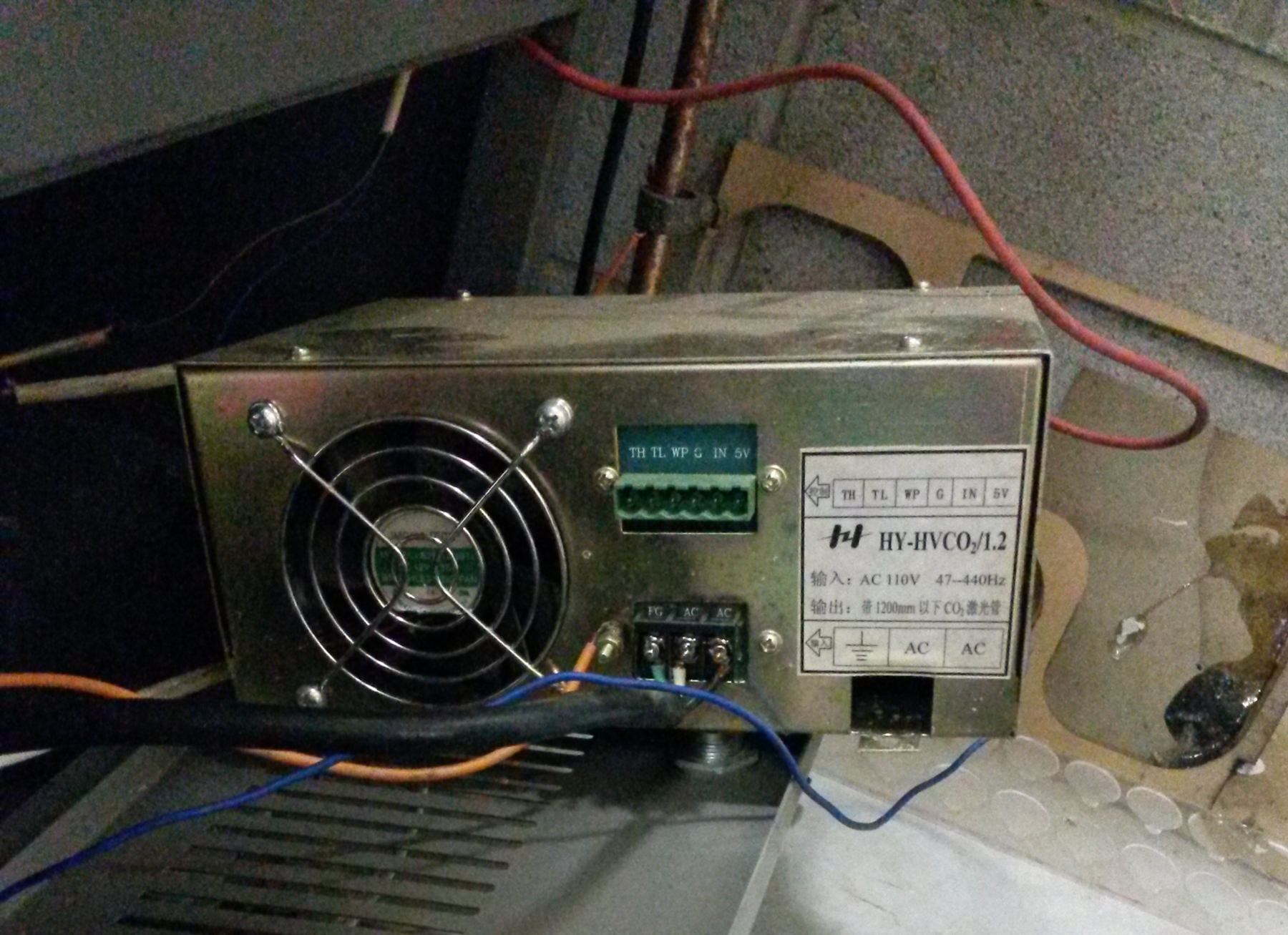

I'd like to go up in power to 60 watts or so. Also I need to replace the water pump. I've never been impressed with the flow. I have a 6 gal. reservoir with a cooling coil on a thermostat. Here are 2 pix of the PS I have.
Questions?? Will my PS work on a 60 watt tube? I think it will. And, what submersible pump would I need to keep it cool. The tube is about 55 inches above the pump.

That power supply was from HungYung that we used to carry. It is a pretty good power supply. You can use it to power a 60W laser tube as the max current it can output is about 25~26mA. For RECI 80W, I don't think so. Even though you may be able to light up the tube, but you will get two troubles
1) Not being able to drive the Reci 80W (W4 tube) in full power. It need 28mA
2) You will drive the power supply to peak power and will cause over-heated on the 60W power supply. Soon the choke and a thermosistor on the PS may melt down or break
By the way, REC 80W tube is running 1.45m and a 60W is 1.2M. So, the lenght is not the same
