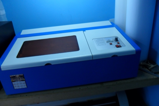

Well now is the time I have a K40 and now I will do the conversion it soon

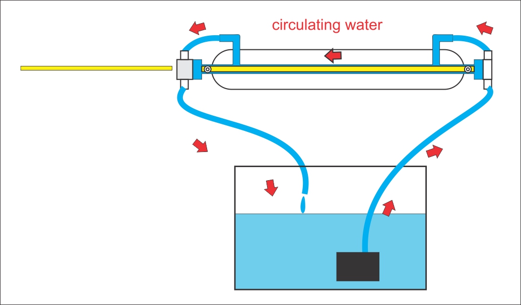

I would like to help someone ... how do I test the laser tube
I already have the hoses, tubing, fountain, water bucket.

if you fill the tube with cooling water ( distilled water only) make sure that there are not air bubbles inside the tube or you destroy the tube.
I not clear if you got aK40 what do you wana do??? there is already all build in.

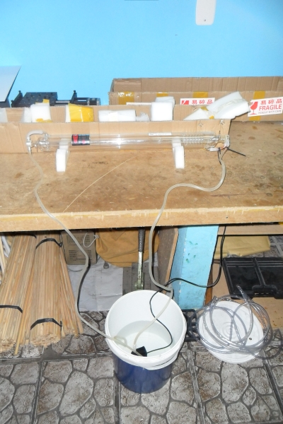

Hi .. thanks for the feedback ...

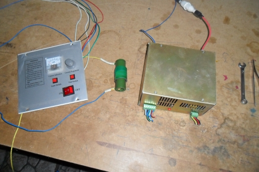

THINGS...Yes I have power supply (I'll attach some photos below.)
if you can tell me I am grateful
WALTFL On the water ... I tested using ordinary water, but the water which would be the best?
- Distilled water for laboratory

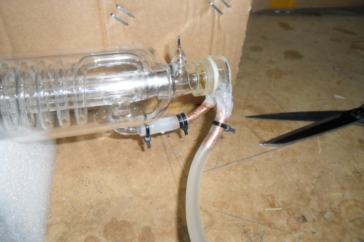

...I noticed when I received my tube that was broken part of the piece where the mirror cools did a repair. (I'll attach some photos below.)

- k_40III.jpg (118.06 KiB) Viewed 5380 times

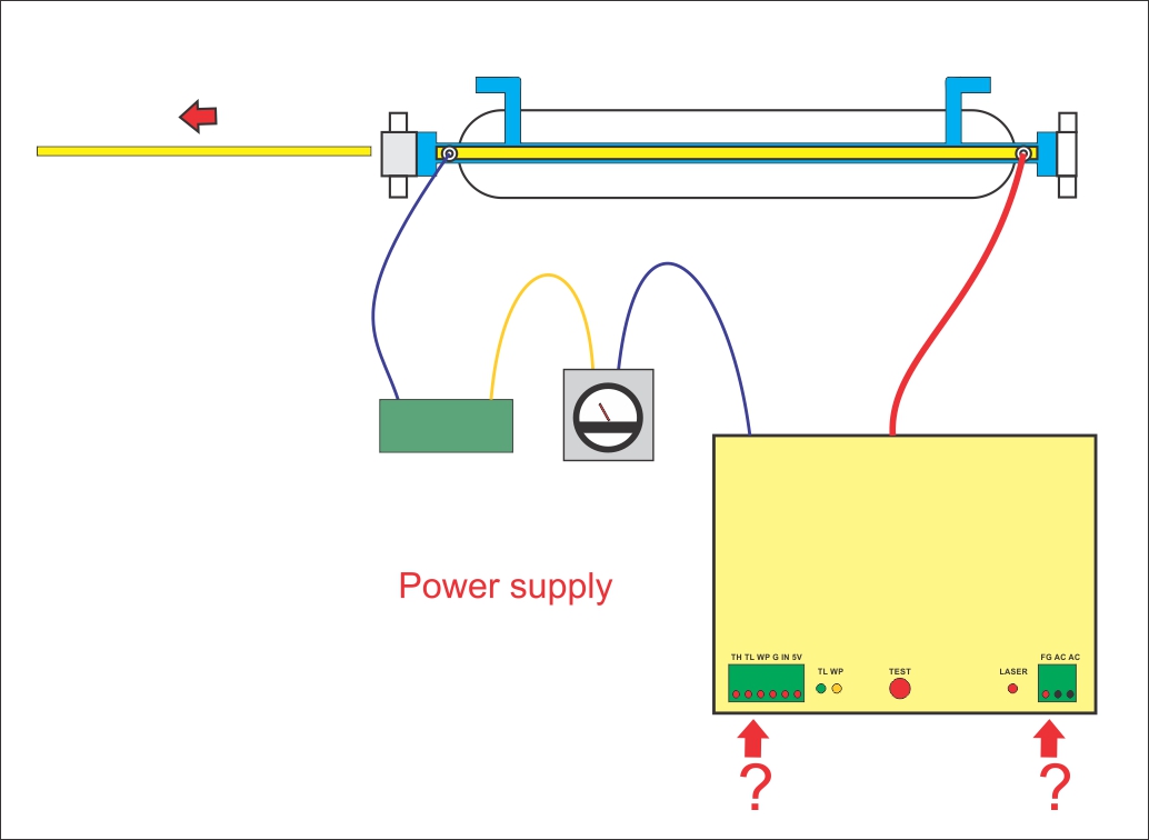

....I did more drawings to better understand ... correct me if I'm wrong.
thank you...

Download the laser power connection diagram from this location: download/file.php?id=32

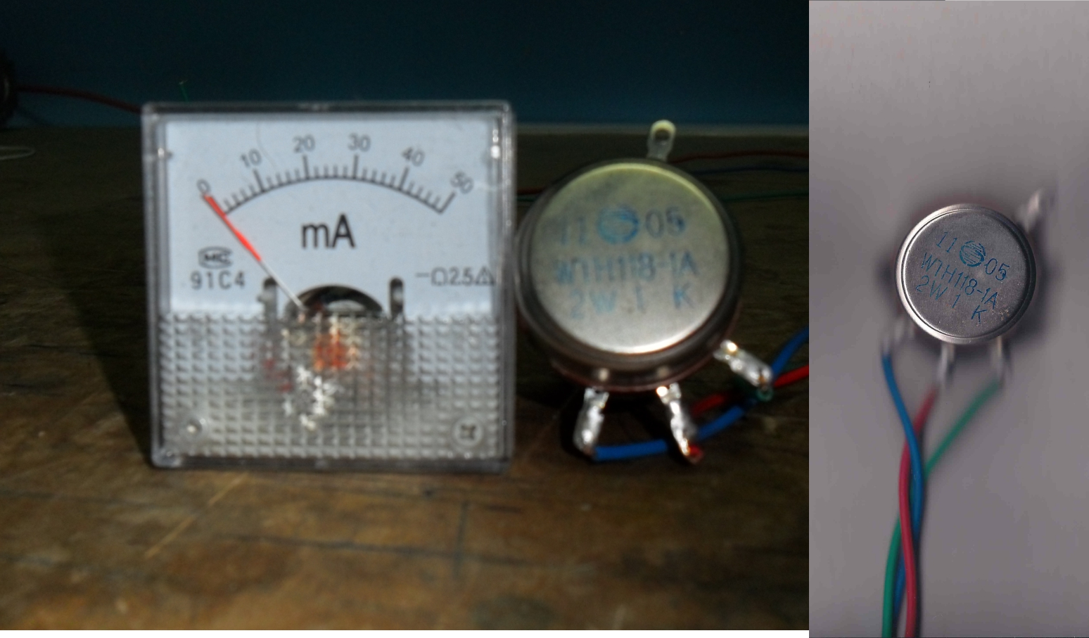

You need to get a 5K or 10K potentiometer (VR) for power adjustment if you're not using DSP.

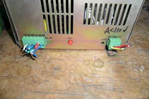

this piece is the K40 ... 40w laser tube is with these pieces I can do the installation?
and also I did not understand the means of connecting the power supply ... I will attach another picture.
if we speak
big hug!
if we speak
big hug!

Re: connecting 40w co2 laser tube?
Did you see the link I sent you from my last reply?
That show you the connection of connrcting a power supply. You don't understand it?
