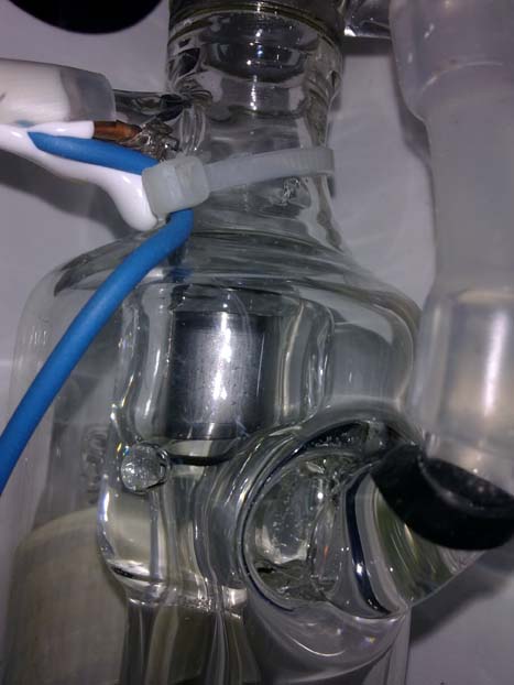

Cooling water level too low pump was drawing air: Added distilled to reservoir= Increased waterflow better water exit from tube behavior > nice bubble

first there never should be air bubbles in the tube this will destroy the tube

Thanks Waltfl for clarity on the laser tube and air bubble- I was under the impression that a small bubble near outlet was ok. I cleared the small bubble near top outlet by rotating the glass laser tube slightly, very slightly up to center. Amazing the difference this small change of a couple of degrees made; the persistant air bubble cleared and the tube remains air free.
