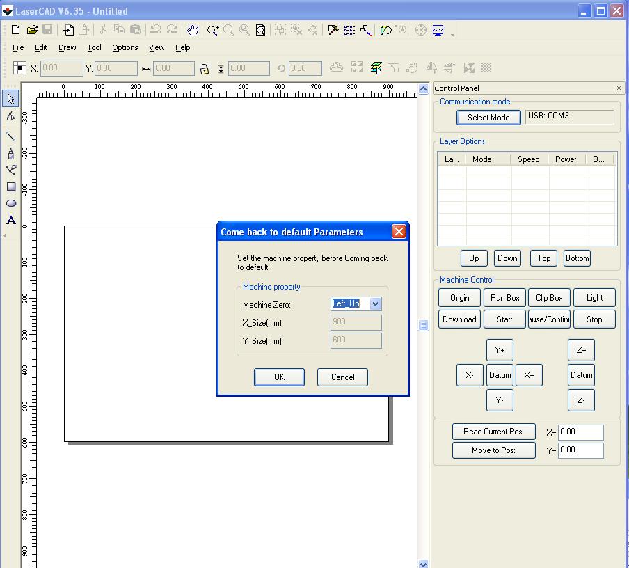

I've found the problem!
options--->position relative--->select left up.
That was the problem, now it is left up again.

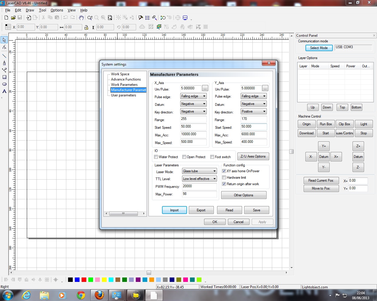

Dear Marco , thought I'd upload a picture of the control panel to see if you can see anything amiss. Hope this is of help

Hello again marco , I've been tinkering around today to see if I could get somewhere with the machine as I'm sure it's on the point of firing up. I seem to have got round the engrave beyond size problem ....I now find that the head moves as though it's engraving but the laser doesn't fire ....I'm perplexed also the y buttons on the led console now work in reverse thinking I had put the stepping motor wires back in the wrong order I changed them and then found that the head locates to the bottom of the cabinet instead of the top.
