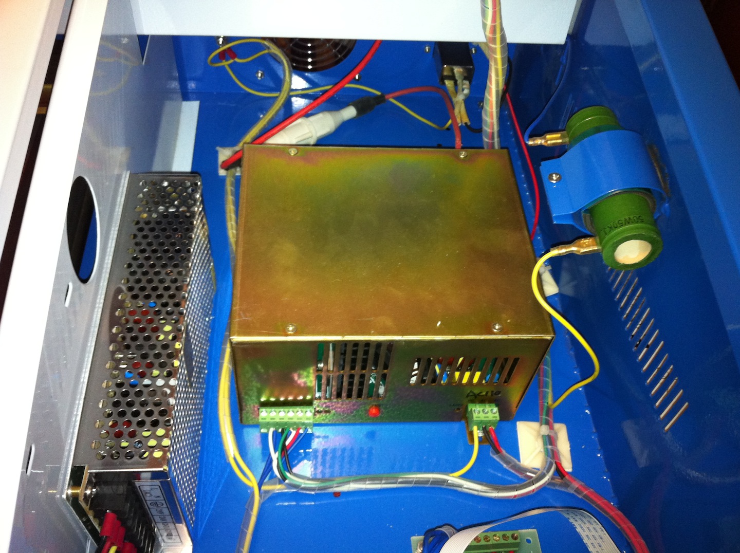

My LPS is the one that came with the machine from factory and it looks like this...
Is this the kind you sell, is it a good one?
... If i get the 60w tube, will this ps work ok with it?
Re: CO2 Laser Tube issue.
Sorry I can't tell. Even though it looks similar, the internal circuitry, components, and quality play the role.
Plus, I don't think the K40 can accommodate a 60W laser tube which is too big for the K40 to use it.
60W tube should be in 55~60mm diameter while a 40W tube is 50mm. The length of a 60W is 1.2M (ft) but a 40W is 850mm (2.8ft).
It's not difficult to fix the length but the diameter of the 60W will give you a big trouble. So, forget about thinking to upgrade to 60W for the K40. Focus on a 40W tube!

Just curious about that green element sticking at the right side, is it for grounding purpose ?wctx1977 wrote:Hi Marco,
Is this the kind you sell, is it a good one?... If i get the 60w tube, will this ps work ok with it?
Axeman
- Posts: 120
That looks like a big fat Capacitor. For what...I'm curious.Meshal wrote:Just curious about that green element sticking at the right side, is it for grounding purpose ?wctx1977 wrote:Hi Marco,
That is a high impedance resistor. It exist on most K40 machine. The reason it is there because the original power (open case, non pwm) is no good. I believe it has bad triggering voltage that is too high and it may cause damage on the laser tube. That's why they put it there in series with the laser tube to limit the surge current. If you have a quality power supply like the gold case or ours (black now), you don't need to have the 'green monster' installed . But there is no harm to leave it there, though.
