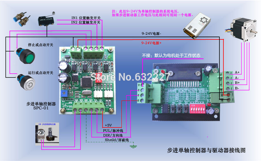

I received my shipment today.
Is there any connection info for the Stepping motor controller board & tester?
Please advise. Thank you.

I had the same question - found these =)
Servo Tester 1.jpg (37.51 KiB) Viewed 48051 times
