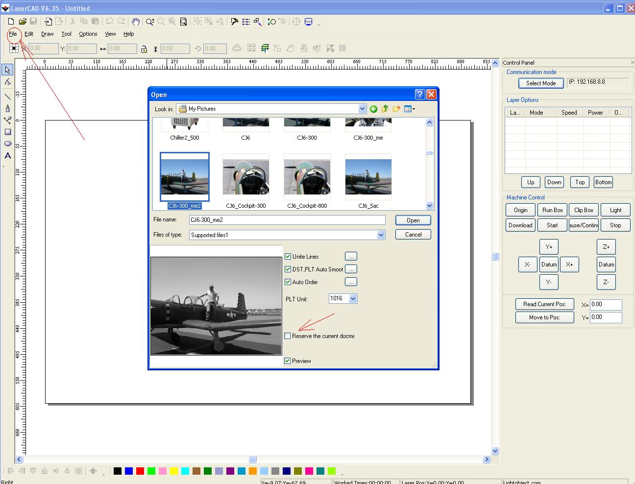

Is it possible to open multiple files in Lasercad at the same time? This would make it possible to open a dxf file for cutting and an image file for engraving on the same screen and lay them out appropriately.

You may import different file into LaserCad and use layer to separate it. To enable the layer, just put a check mark on the laser. To enable multiple image, put a check mark on "Reserve the current document" and it will allow multiple images to be imported

Thanks! I didn't see that! It is exactly what I was looking for

now I am not sure where can I find this " reserve the current document" and where to put the checkmark on the laser??

When you're doing image importing using the "Import" feature by clicking "File"
The option is right at the bottom of the pop up screen

thanks , I never look down there.

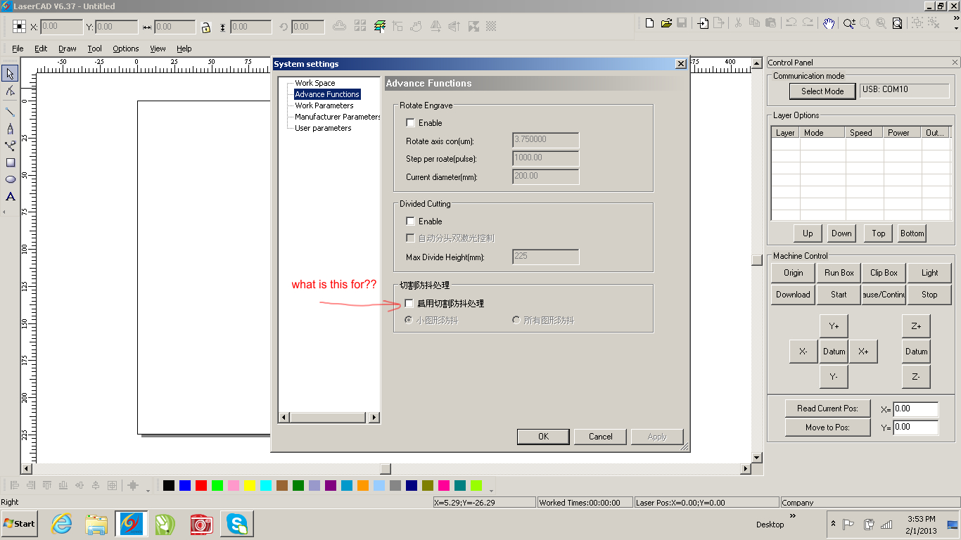

did you find out what the chinese language stuff means in the new lasercut manufacturer settings means???

You lost me. Where is it?

its this here see attachement
