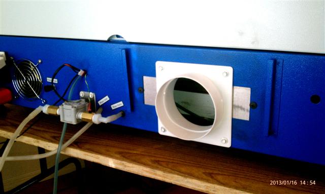

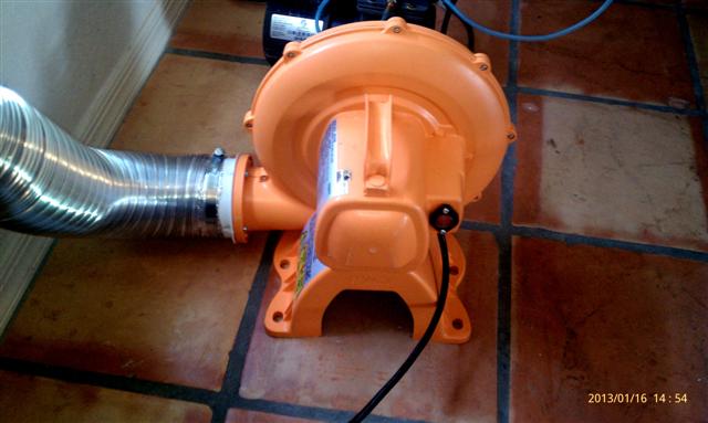

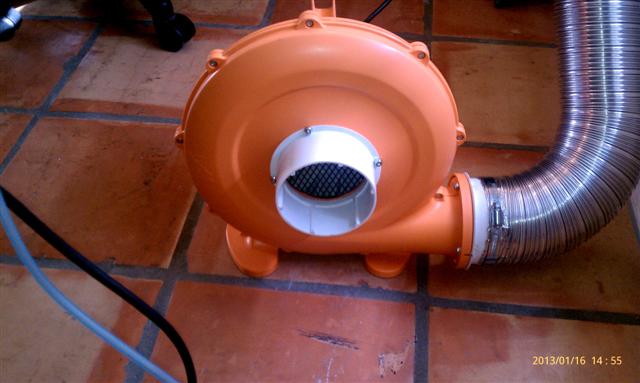

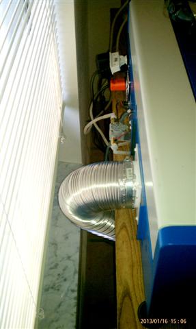

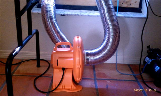

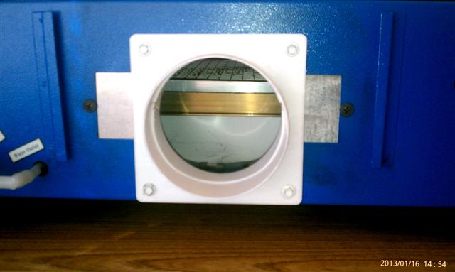

I've been looking for a good (and inexpensive) exhaust blower for a long time as the original is pretty much USELESS. I was at a friends house recently and he rented one of those air bounce houses for his kids and I saw the blower that keeps it inflated and thought that would be perfect.
So I found one on ebay for $42. free shipping and got it. Hooked it up yesterday and it works better than I hoped and it's pretty quiet considering how much air it moves. I test engraved a piece of pine deep on max power and I didn't even smell it in the shop, it was blasting smoke away 10 feet outside the shop !
Here's some pics, maybe some will find it helpful....

i have blower like this and that's enough. This is the outside end of the pipetheking wrote:Hello Good idea !!!!! is it 4 inch exause ???? and please give me a link on ebay for blower ??? Thanks.

Here's another one on ebay now, http://www.ebay.com/itm/HUA-WEI-MODEL-W ... 1c2f6affe4 I added those white PVC 4" adapters to the blower, got them at home depot for like 2 bucks each.
Teac, I had 2 of those PC fans running into a 4" pipe and sealed well and it was definitely not enough flow for me, smoke and fumes would still get inside. I can cut and engrave acrylic all day now and never smell the fumes with this blower running.
