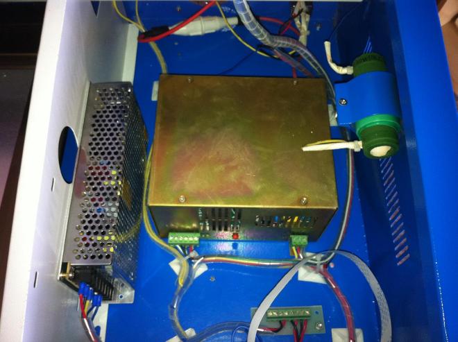

You don't need a stepping motors as the original motors will work. The power supply... well depends what you have in your machine. Post a picture here and I may be able to tell.

Is my ps on the machine if i buy the kit i need other parts ??? or is completed kit ? sorry my english.
- IMG_06941.jpg (46.51 KiB) Viewed 9427 times
Re: Dsp Kit
Yes, your PS is good to go

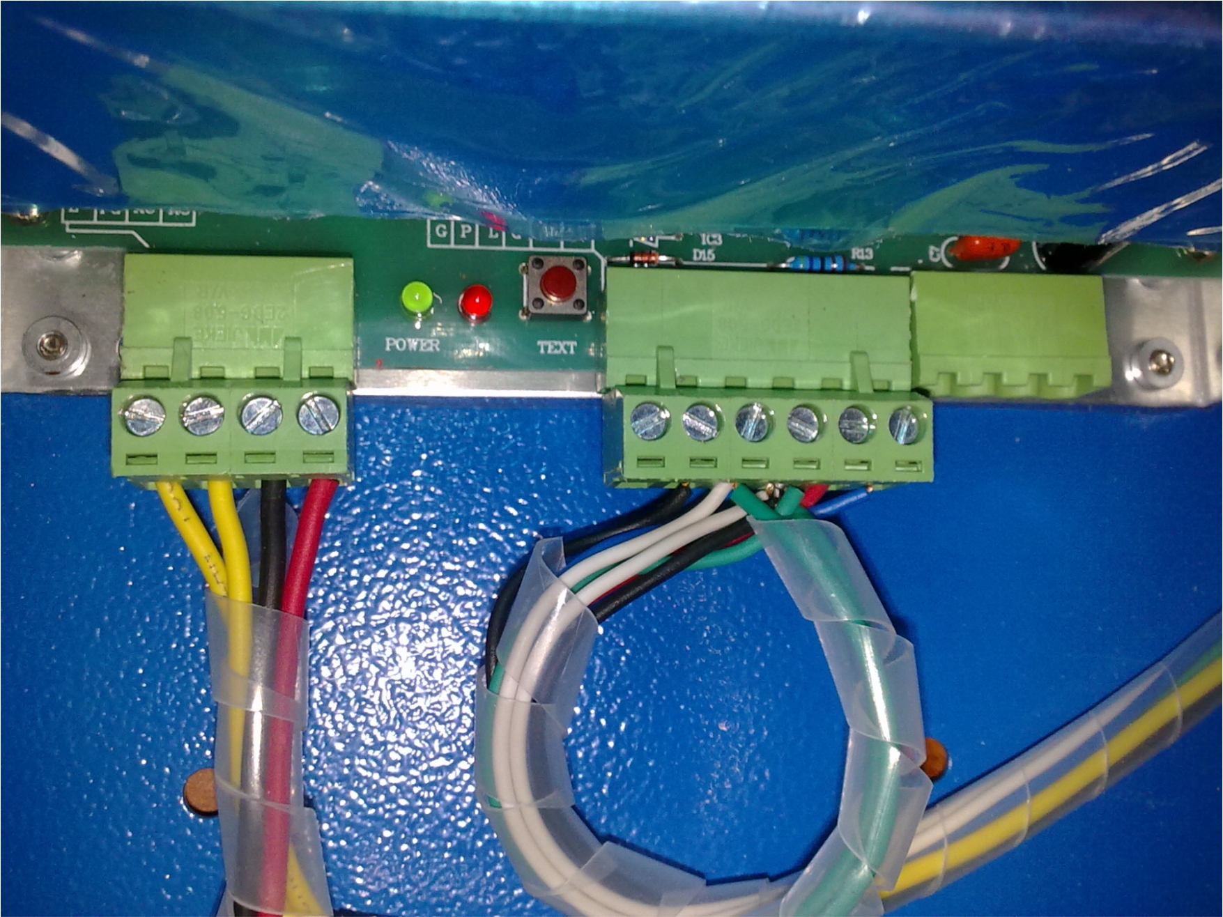

I have to do the upgrade of my k40 and I am preparing a list of things to buy:
1- you can tell me if my power supply (40W laser) is okay? (see photo)

Re: Dsp Kit
Not sure if you received my reply through email. This PS is not a good one for the DSP. Even though one may be able to use it but the quality of output is not really showing the true work from the DSP. Plus, the connection is not very compatible/standard as it is an analog PS but not a PWM so I suggest you to get a true PWM PS either from me or from other party
