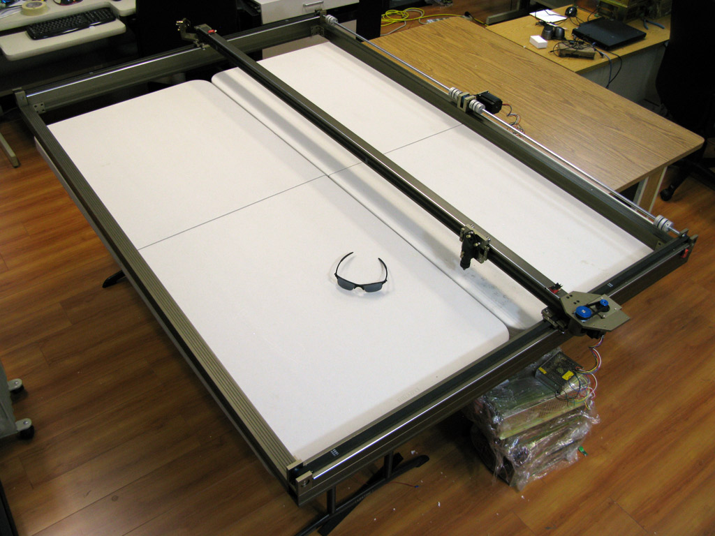

I just set up a 1200*1800 XY stages and didn't realize that it's so big after the kit has been set up!
The overall dimension is 89.5" x 57" x 7". See attached image. Note that I put a pair of sunglass for ref. Also, pay attention to the 150W CO2 laser power supplies underneath it. So, you know how big of the stage now? :mrgreen:
Once it is ready, I'll setup a complete CO2 system performing a bunch of testing. One thing that I'm anxious to do is to find out whether a Reci 130W tube is powerful enough to cut 1mm stainless steel or 2mm aluminum plate. The issue is that where can I get a bottle of pure "O2"? I need it for helping the CO2 laser beam to cut :?:

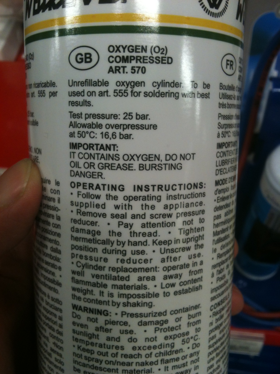

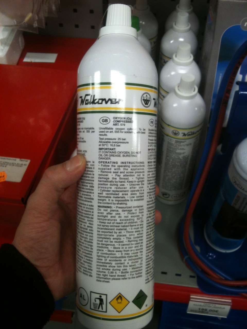

maybe you can use bottle like this

But first thing I got to do is to find a support table for the stage. It's just too big to be hold by two of fold table.
I may need to to get some 4x8 wood block from HomeDepot to make custom one for my need. Can't wait to see it in action

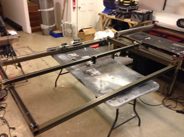

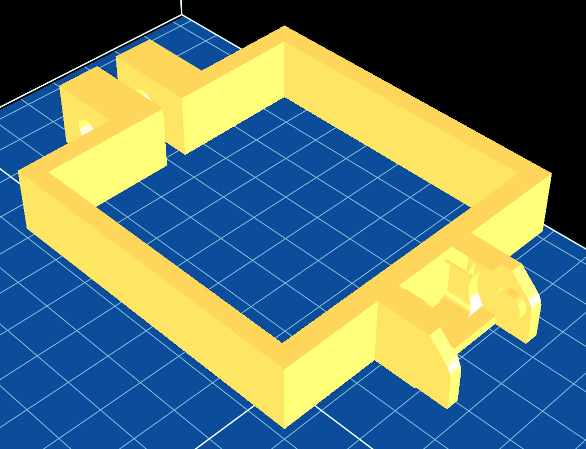

I just got mine assembled tonight and I was surprised on how put together it already comes and everything included in the kit. It took me less than an hour to get it assembled, now all I have to do is wire it all up and build my frame. I'm going to weld a frame out of 1"x1" square tubing with a platform for mounting the tube and mirror on the back. I should have it all done by the end of the weekend and I'll post pictures when it's done. I also have some 3d designs to help with cable management. I designed a cable chain that bolts on the Y-Motor and has room for the air assist tube, motor, limit switches, auto-focus and laser pointer. I'm currently making a mounting solution for the x-axis. Once if finish those I'll be posting the designs on thingiverse for people to grab.
I wouldn't suggest replacing the air assist with pure oxygen. Think about it, that O2 is inside the nozzle right on the lens so basically you would be making a flame ball right on the lens. I would think a separate metal nozzle pointed at the work piece if you want to try. You can get any size and any amount of pure O2 from a place called airgas they have tons of locations everywhere so it's easy. You can save money by going to harbor freight and getting a regulator and hoses and even a nozzle.

Thank you very much for the video and very helpful information. The video really helps me to better understand the concept "huge" when it comes to this gantry and that makes me realize that this particular model would be too much to handle for me and I won't be able to take full advantage of its capacity. May be I should look at the XLE 600*900 instead. That will probably do most of what I want to do with it.
