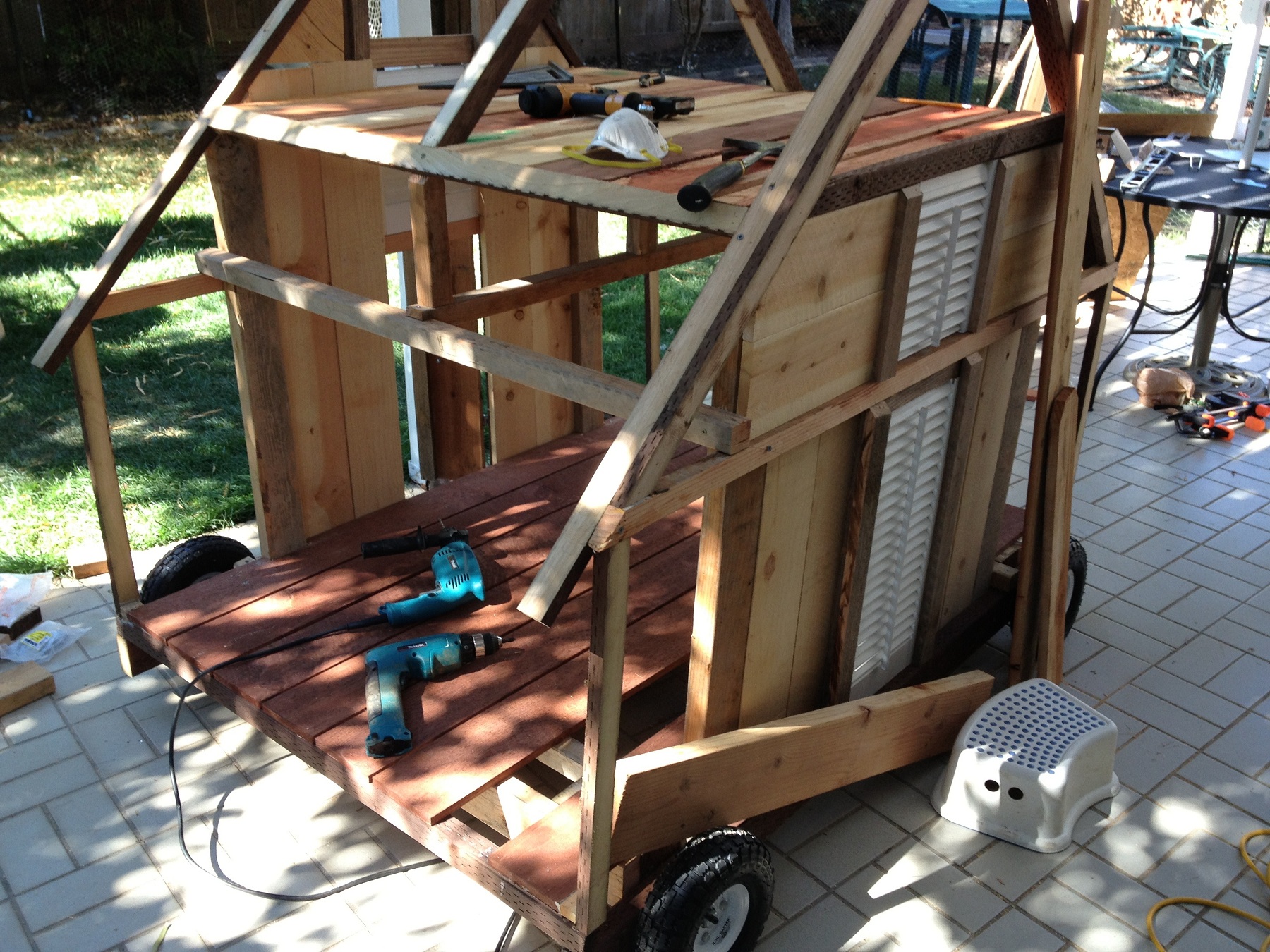

I will pilot this project following the list you suggested. By the way, I already completed the framing of the duck house. This is the picture showing the framing I completed recently. I believe the electronic components you mentioned (the charger, diode and battery) could be able to fit inside the attic I specially made for this solar project (in the picture attached, please see the upper section of the house).
After confirming the shopping transaction on your website, how soon can you send us the components (except the battery. I will use mine)? If I understand correctly, they should be in stock.
Much appreciate your continued support.

Re: solar system for my duck house
Yes, all items are in stock and ready to ship
The house looks good, can't wait to see it housing your duckies

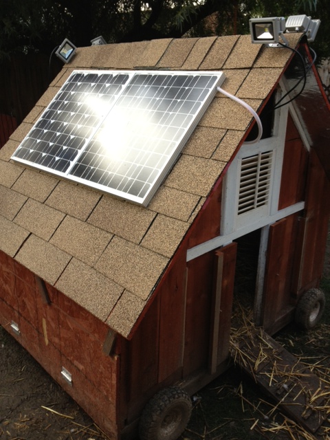

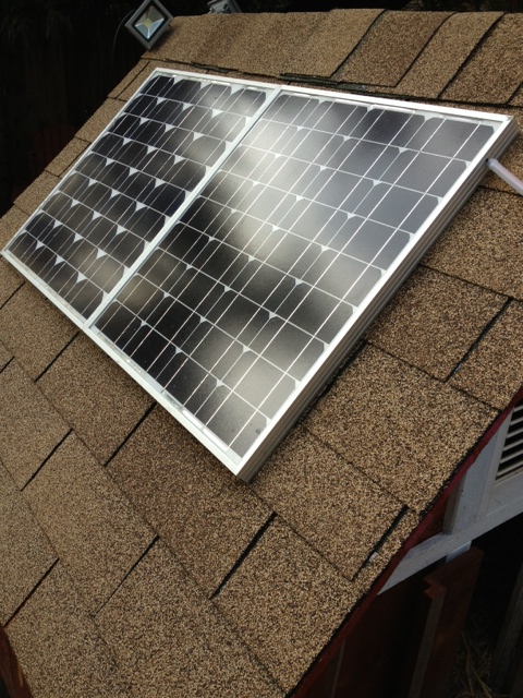

I just completed the installation of the solar system which drives the lights from the roof of my duck house - just in time for the arrival of our ducklings too : )
The 2 solar panels powers 4x 10W LED lights to decoratively illuminate our yard at night. They also add security too!
My family are so happy with the results of this project. Our kids, particularly, are so thrilled that we are able to harness the sun power for FREE.
Thank you so much for your support on this project. Your input has been very helpful to our success.
Looks great! By the way, did you install the diode in series with the panel? Make sure you do it or the 'back-flow' current from the battery or the unbalance voltage from the solar itself are not good for the solar panel.
How many hrs of light did you get?
