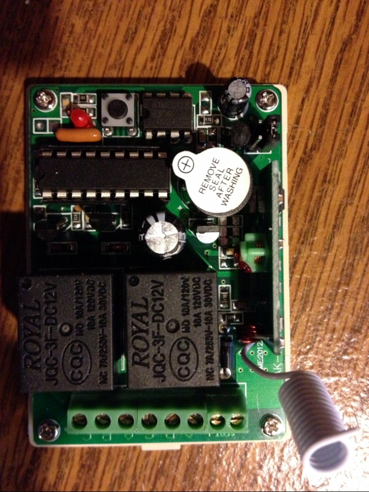

looking for instruction manual for 2ch tx rx
remote_cb
- Posts: 6
- Joined: Fri Jan 04, 2013 3:27 am
looking for instruction manual for 2ch tx rx unit that I bought 2 from Ebay
http://www.ebay.com/itm/230384429571?ss ... 1439.l2649
The unit does not have 3 jumpers - it has only 2 but has your watermark name on item picture.
any ideas?

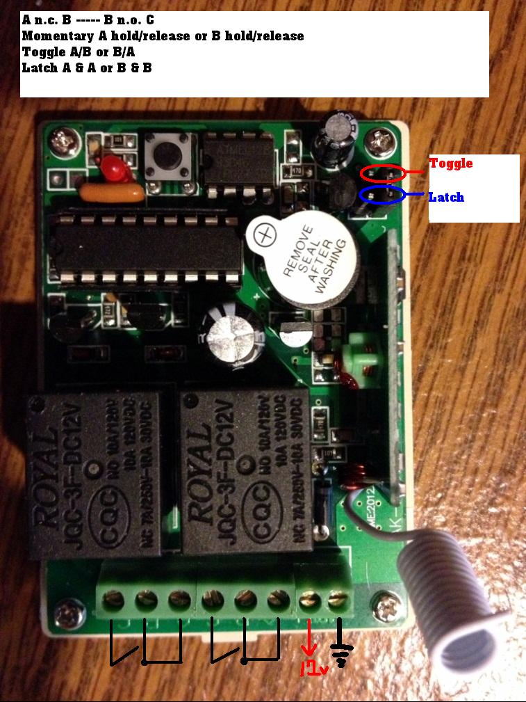

The answer to my own question (because I had to figure it out myself)
What company does that? No instructions, No Replies, No Help ...A nice way for no repeat bussiness!
For those that got stuck with this unit, This is for you.
Any question, let me know and I will try to help you.
As a note, you might want to use an external relay for higher power output. Just wire in an external relay by using the secondary of board relay(s) to energize the primary external relay(s).
If you are not sure how this is done just google "how to wire a relay". There are many options but be sure to use a diode clamp to protect circuitry from spikes. and always use a fuse or cb!

This is how to "beef up" the relays and protect your board relays by using an external relay to handle the load
Go to: http://www.falstad.com/circuit/
import txt for circuit simulator
Special note: Time is slowed way down for simulation purposes so don't be alarm about the clamping diode and speed of relay contact release time. It will be at the speed of light.
copy and paste this code into import box
