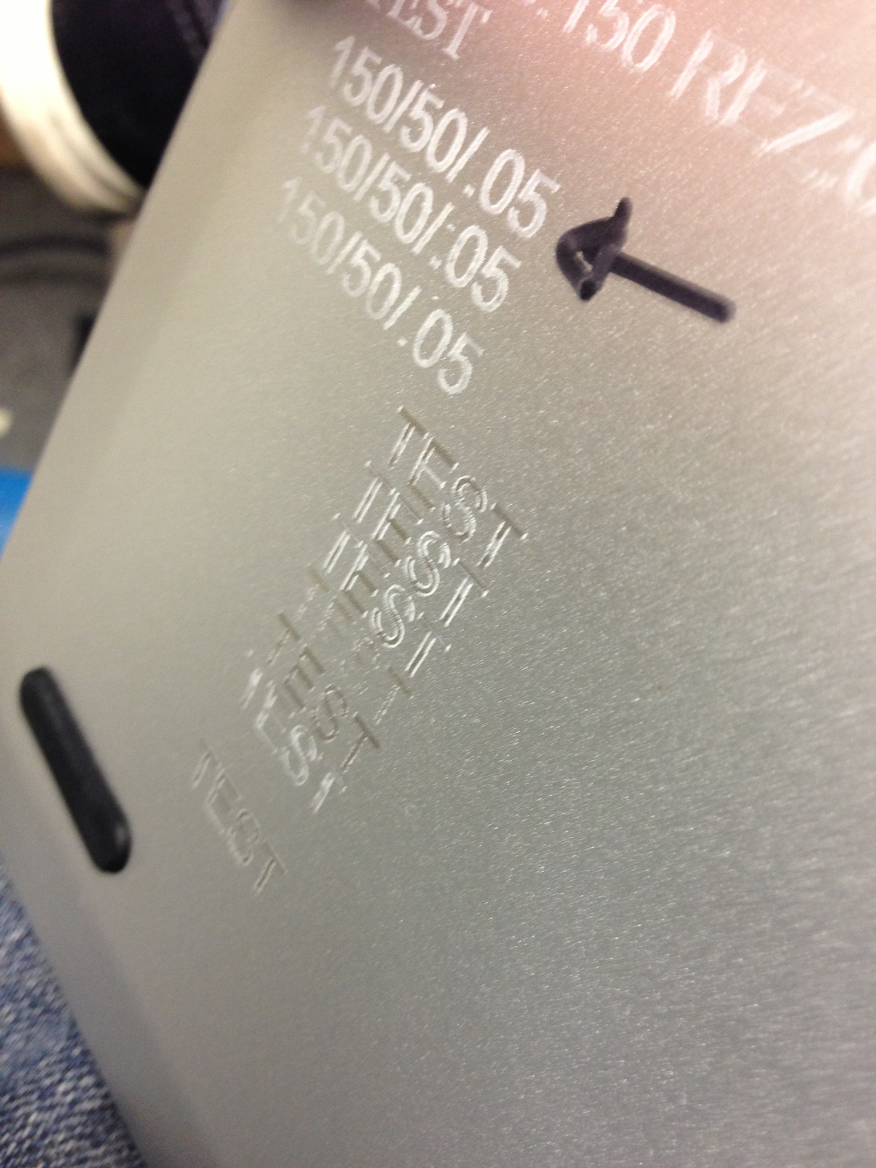

I’ve been having some weird results with my converted k90. I’m trying to raster anodized aluminum. I got some settings that I was happy with and it was working well. Without changing the settings or the material after a while of lasering I started getting brown parts. The “Test” text in the picture is the same setting as the “150/50/.05” text. I believe the brown indicates that the material isn’t getting enough energy to engrave all the way and turn white. Is this correct? Why is this happening???

I've always been on engraving but when I check the PPI box it works much much better. Any idea why this is?

I don't think that you're doing engraving for all those charactertics . The "TEST" surely look ike it's running in 'cutting' mode. Was it on a single layer or multiple layers?
The "PPI" is designed to work for better result when doing 'cutting'.
You may post a screen shot of the LaserCad on both drawing and the setting. If it's on a single layer with engraving setup, it surely weired enough

Re: brown parts when engraving anodized aluminum
