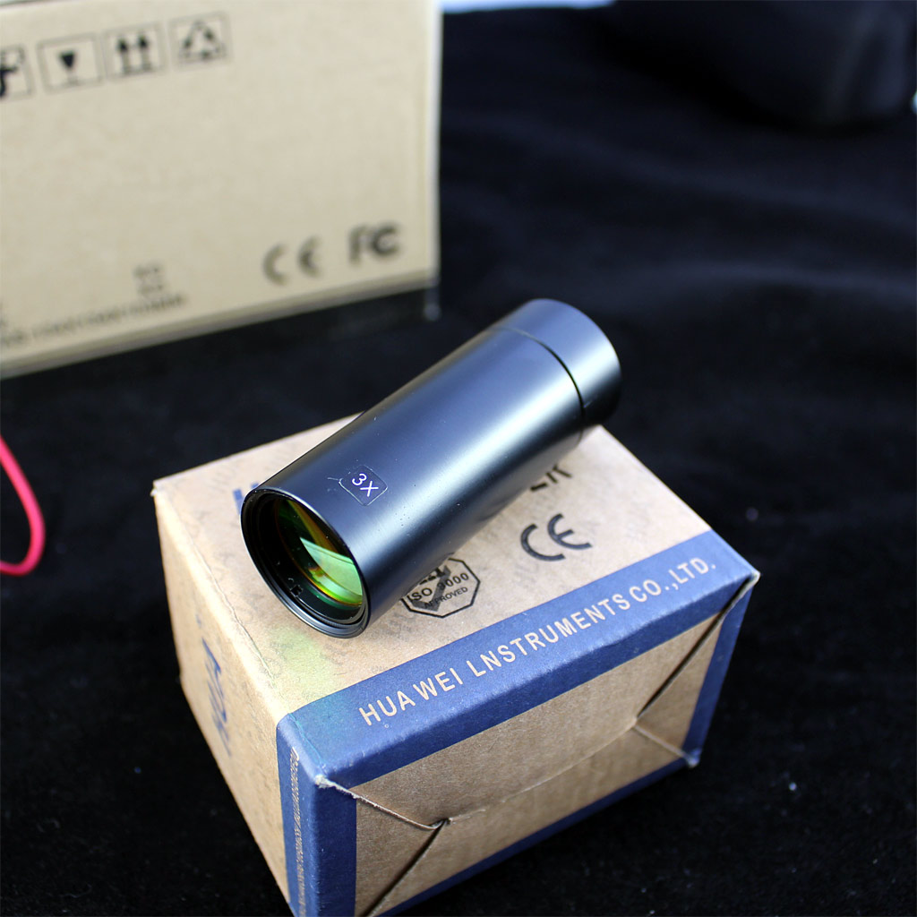

I believe that regardless the size of the machine, with a beam expander installed means that you're getting more power boost by 20~30% . Plus, it release 'pressure' on the mirrors and the fcouse lens as light beam diverage to 2x or 3x. So, technically speaking the surace of lens and mirror take less 'hit' (heat) and should last longer. Just think about a toll of a bride; 4 station and 8 station, which one can pass more car traffic and less stress on the collectors?
It's just my simple through. I'm not an expert so, you may need to do more research.
I do have 2x and 3x beem expander here (two left on each ). I haven't had chance to post it. I'm totally occupied...
Re: Beam expander + beam combiner
See pictures of 2x and 3x beam expander

What are the input/output max diameter? A 150w reci tube has beam diameter of around 10mm

By diameter, you mean input diameter? Or the physical diameter?
The RECI beam diameter is rated at 8 mm, so that would make the output 16 mm with the 2x and 24 with the 3x. Juding from the pictures, the unit itself is 20-25 mm in diameter, so I doubt a 3x would work. Could you confirm.
I think I need to take more picture to show you what is that as it could be considered as Input or Physical size. The 2X got small input hole but the 3x is bigger. However, there is a mount that make 2x smaller and if you take it out, it seems that it can take wider beam. I haven't had too much experience about the beam expander and I'll consult the manufactuer in next couple days.
I'm afraid that the 2X is not going to work with your 150W tube. The beam of 150W is about 10mm so 2x = 20mm. The output lens of the 2.0x has a diameter of 19mm. So, regardless the input is 10mm or wider, the output will be blocked. You may need toget 2.5X or 3.0x instead. I'll get more info tomorrow as I asked them to send me detail infofor the 2x and 3x. Now, I think I need the 2.5x as well. FYI, the bigger the number, the more power you will get.

Great. Thank you. I was about to order it, but ill wait. Right infront of the tube, the diameter is max 8mm. Mirros are 25mm and lens 20mm on the small machine and 30mm and 25mm on the large machine.
A 2,5 expander would make the beam 25mm, that would be fine on at least one of the machines.
Don't buy it yet. I need to order new one for you.
Reason:
2x: Input diameter: 10mm, output diameter: 10mm
3x: Input diameter: 10mm, output diameter: 19mm
It is not suitable for Reci 130W laser or higher tube. I need to get 10mm/25mm or 10mm/30mm beam expander. It will take about 2 weeks
