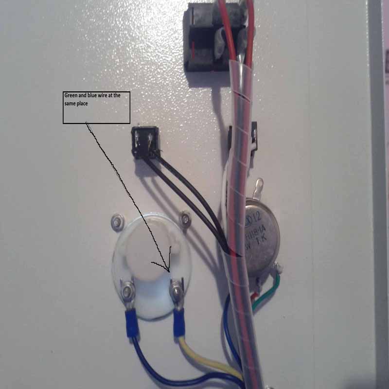

Hello I bought a digital meter 3 digit Mini Blue LED DC 100mA meter. Ideal for CO2 Laser power indicator(100mA) to replace my analog meter on my k40 mocked laser can I connect him(it) directly the digital meter on the borders of the analog direct replacement either or I have to connect ??
let me know where is conect wire from my digital ? and is possible a work 2 meter at the same time analog and digital ??

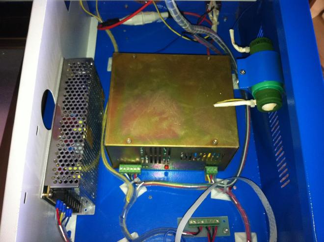

Picture inside my k40

To be sure not me wrong I board is a picture of the connection you thought that this is corect?
