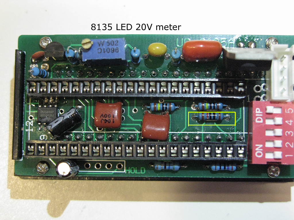

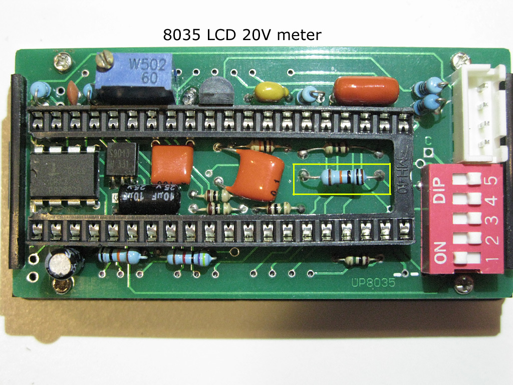

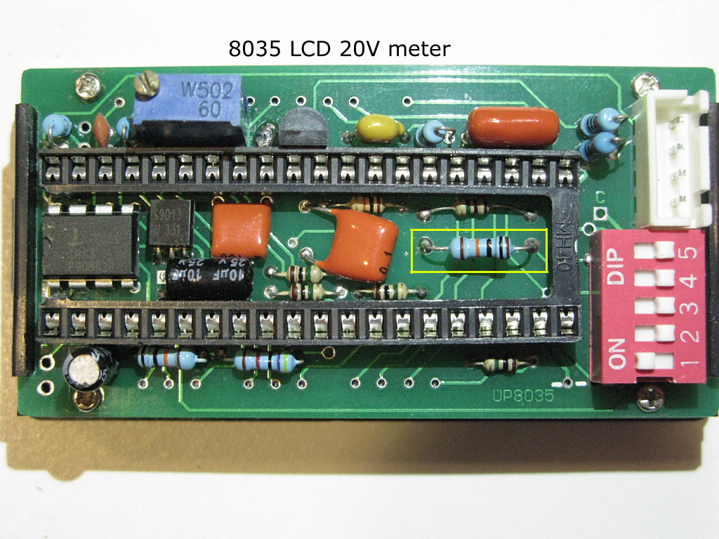

Re: LCD 2v or 20V DC/AC meter, Lightobject Part EPM-8035B20V
I figured out that the resistor should be 100K in order to show 2V when DIP SW is at 'Off' position. If DIP#5 On, it will multiple the voltage by 10 times.
I tested two meter: LCD 20V and LED 20V. Surpised me that the LCD showing "2V" when DIP SW was set to Off. But I need to change the deciminal point to show 1.999V though. But for the 8135 LED meter, it's 200mV. So, I think either they used wrong resistor by mistake or they did that in purpose.
Anyway, use a 100K resistor 1/4Watt to replace the resistor that I high lighted by yellow line
